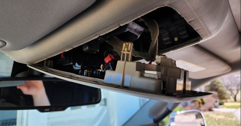

Anyway, if you'd like to do a similar clean installation in your Ram or Durango (other Mopars are probably similar too) it's pretty simple. The hardware kit requires a ground, battery power, and a switched power source. I was able to tap into all three of these in the overhead console. The rear power sliding window switch was an easy source for the switched power and ground, and the always on power I pulled from the Homelink wiring. The overhead console is just snapped and hooked in place. Pull from the rear to unsnap (don't do this during extreme weather when the plastic is either brittle or soft), then unhook the console from the front to disconnect the wire connectors.
Unsnapped overhead console. Pull down from the rear, then unhook from the front.

[img alt="Accessory (added red wire on left) and ground (added black wire on right). The Acc+ wire supplied with the hardware kit is yellow but I used a slightly larger wire and spade to piggyback with the connector to avoid cutting the original wires. After wrapping the bundle tightly with self-fusing silicon tape, the connection is reliable.
"]https://cimg4.ibsrv.net/gimg/dodgeforum.com-vbulletin/516x543/small_acc_and_gnd_6dd8c9c3e0e687764acaffd175234b9c 3c4a4718.jpg[/img]
Location of Constant 12V wire from Homelink module.

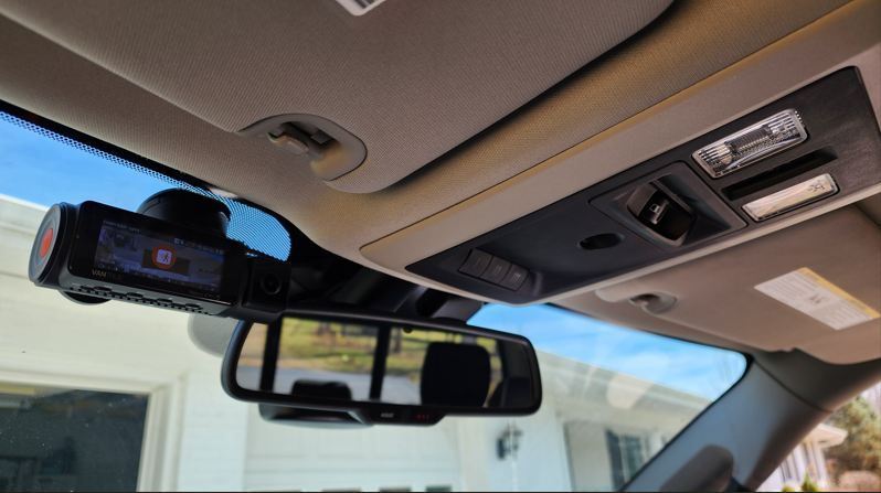

After then running the USB Type C cable above the headliner and toward the rearview mirror, I attached the camera window mount that includes the GPS module. This location provides easy access to the orange "emergency record" button that also has the TF card slot behind it and also gives the interior camera a good view of all passenger locations and out the rear window.

The only downside I've found so far to this location is when the sunvisor is down, it does block the cabin camera. If that's a concern for you, then you may want to change your location a bit. The included wire length of the hardware kit is quite long so you can reach probably just about anywhere on the windshield.
Where I mounted the Vantrue N4 DVR
Where I mounted the Vantrue N4 Pro S DVR

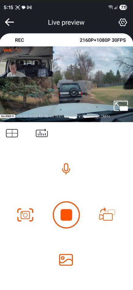

The Live Preview screen of the Android app for real-time viewing of the forward, interior, or both cameras.

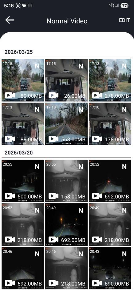

Video folder with separate videos for the forward and interior cameras, sorted by video date.

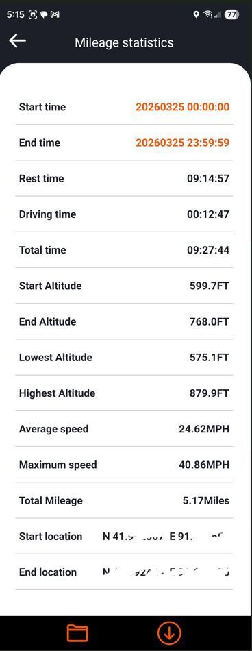

Video file trip summary with quite a bit of interesting data

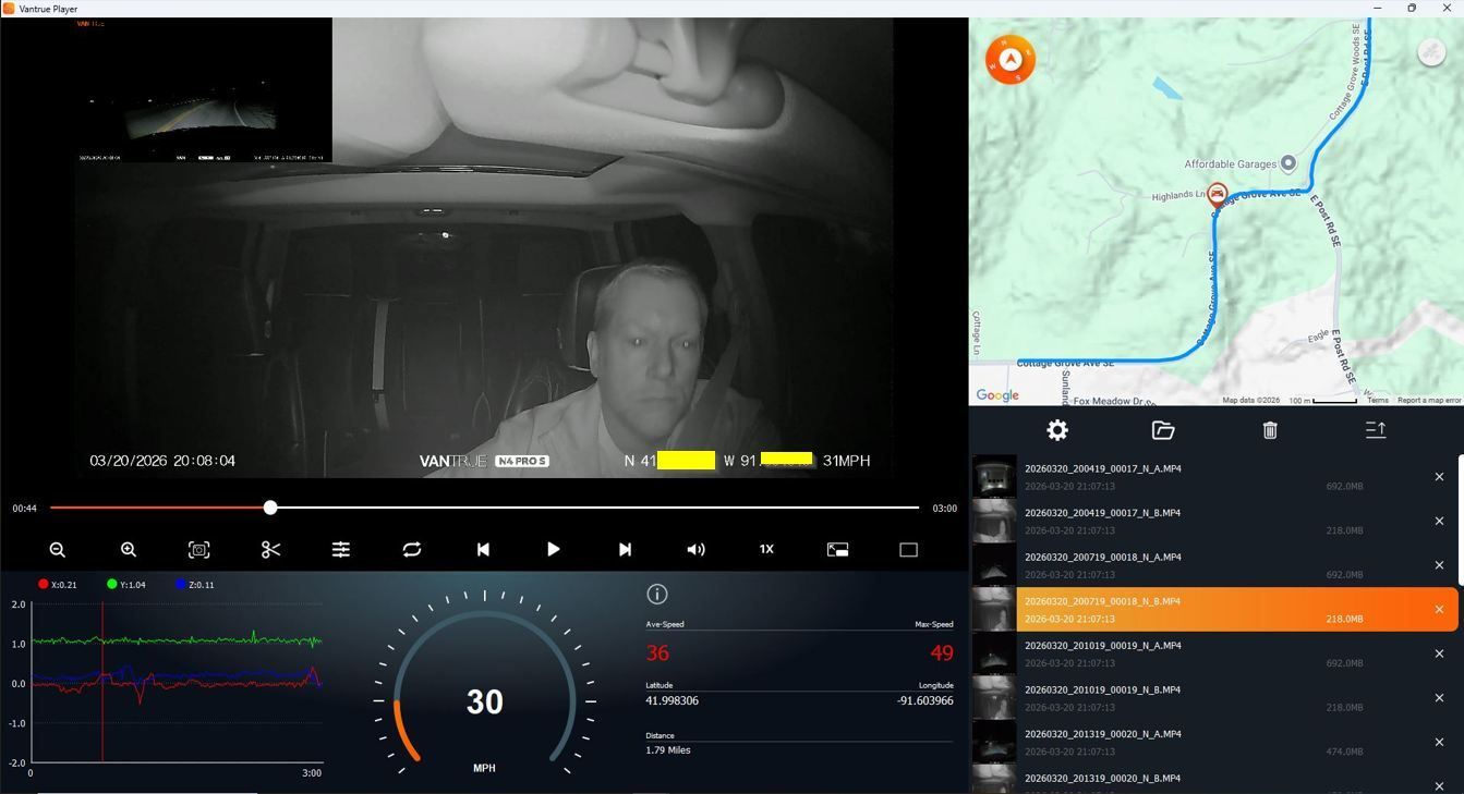

PC application data screen.
Screen capture from PC application video at night.
Screen capture from PC application video at night. This road does not have street lights so the illumination is coming only from the vehicle lights.
