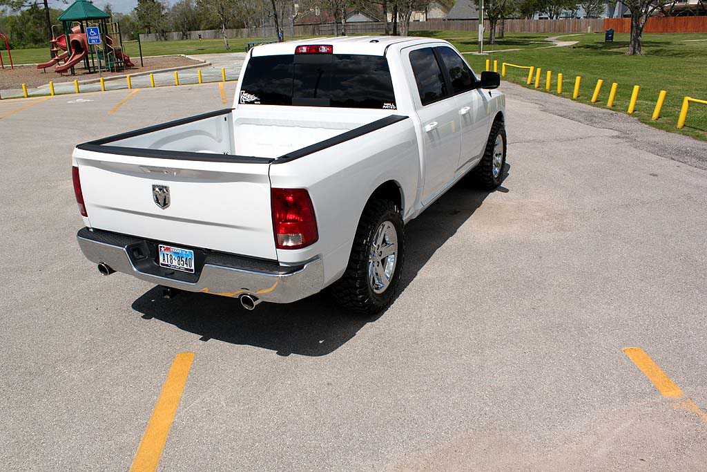

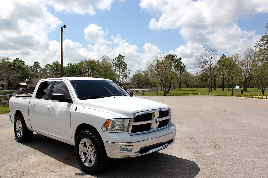

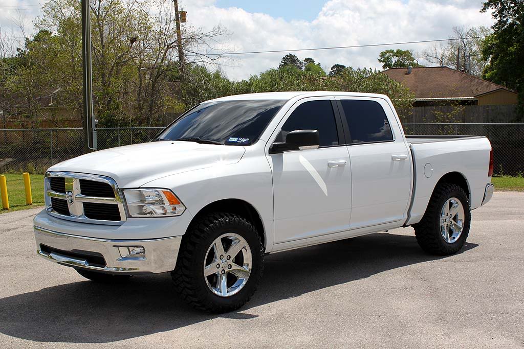

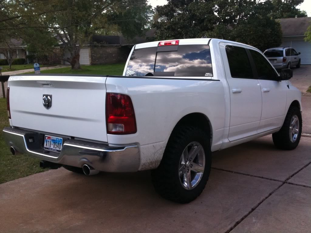

Fat bobs garage 2" coil spacer, 1/4" wheel spacers on front to keep tire off control arm when turning, but as soon as i hit full lock tire rubs sway bar.. 35x12.50x20 mickey thompson mtz

How's the ride with the fat bob's spacer? Any issues with it? Truck looks great!!

thanks! when i first put the spacer in, the front was more jarring, mainly noticeable over speed bumps.. but now that it was broke it self in some(sagged) it rides just like factory.

took the 1/4" wheel spacers off today.. not needed like everyone says. they still hit the sway bar before anything else.
