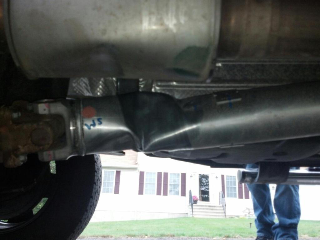

Not normally my section, but I figured I'd share. My dad dropped his 2012 Ram 2500 Diesel off of a ledge today, wanted to show you guys how these $600+ drive-shafts hold up:
Ground Zero
Drivers rear quarter:
Drive-shaft:
That pic was after he supposedly "straightened" in out with his bottle jack. Pics can't show it, but it is literally ripped.

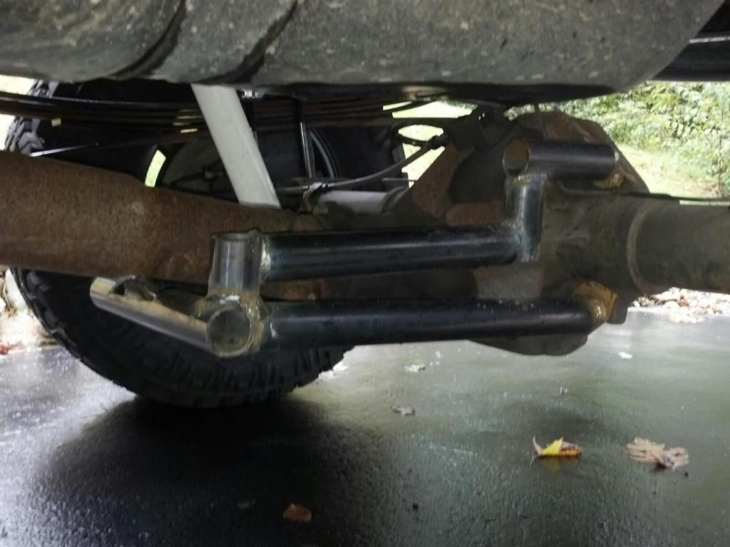

My solution I'm fabbing up for my 3rd gen:

Everyone else, here is what I started on mine. I am getting my 1/4 inch steel sheet monday and finishing the skid plate:

Looks like an excellent way to break chunks off the diff housing instead of the driveshaft. Might want to consider a design more like this one:
http://www.getdirtyoffroad.com/slider.htm
It uses the tubes and the snout of the diff to support the skid rather than trying to canteliever off some welds that will never hold on the housing.
