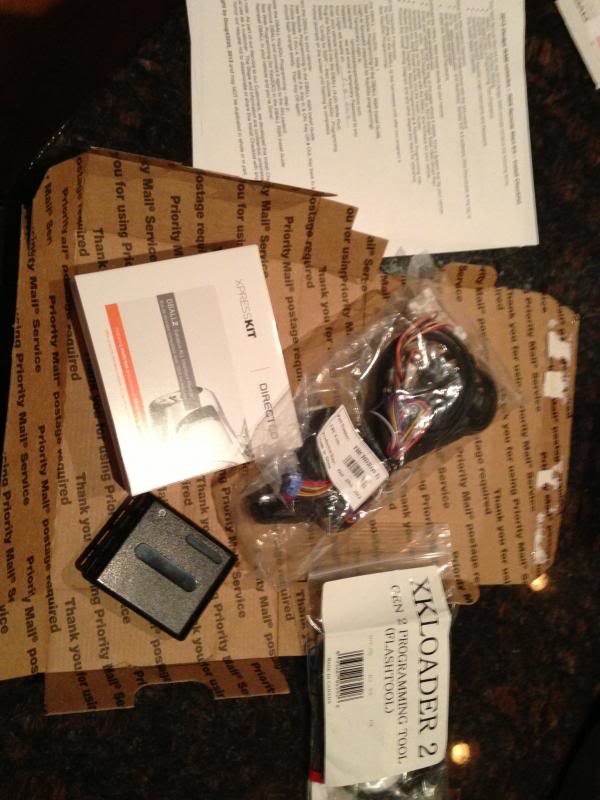

So whats you will receive from Doug (the ebay seller above) if you purchase his kit:
In a small box, you'll receive the DBall2 in original packaging with universal wiring, the XLoader, the harness, and some simple instructions that take you step-by-step. At this point I had already found the RSR wiring guide so I had an idea of what was involved. Doug's instructions are pretty similar, however they are a little more clear in the order that you should do them.
