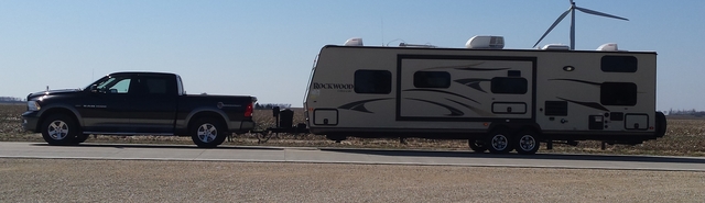

I pull this. 6200 dry weight, 29', quad bunks
