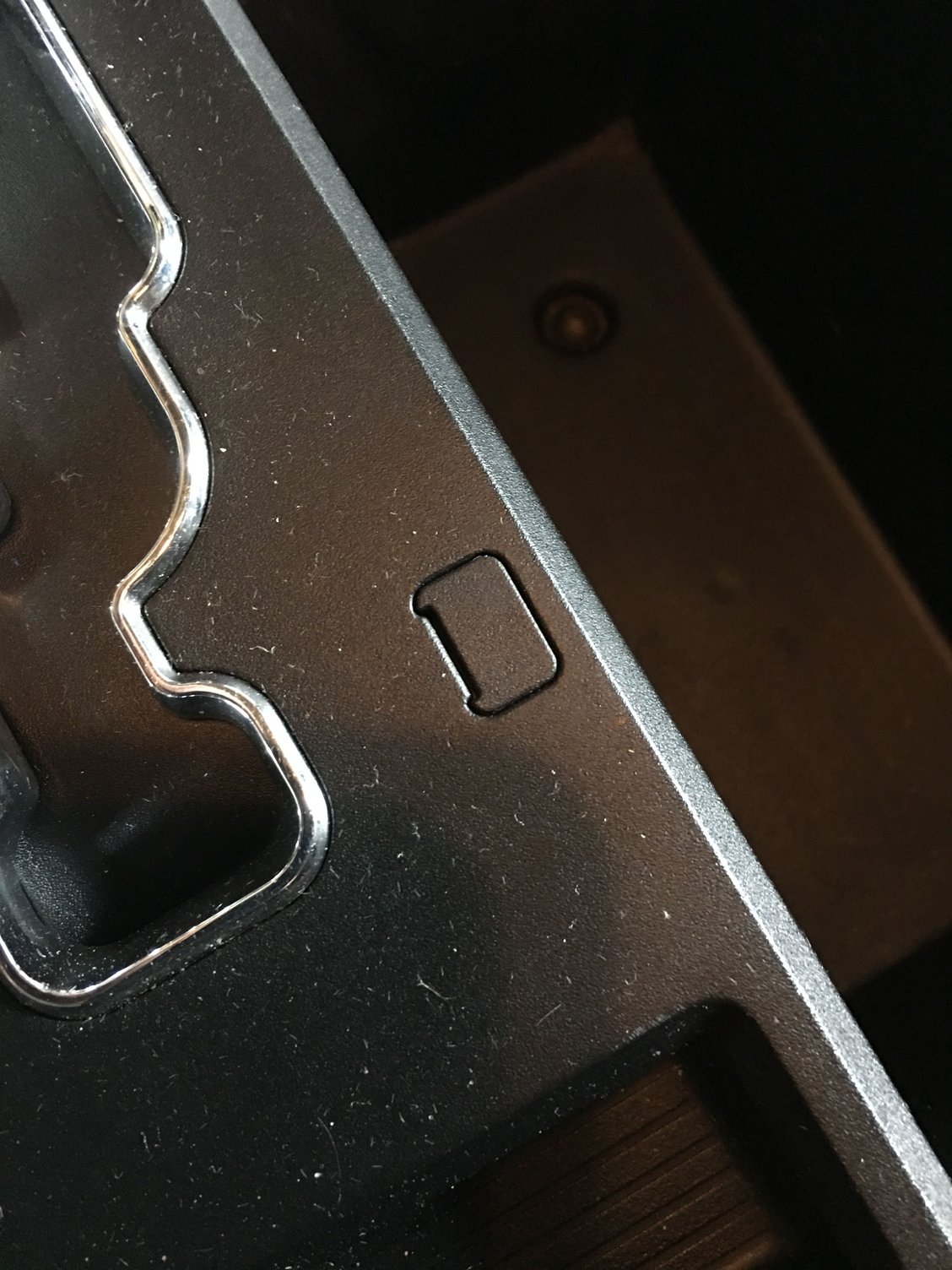

What is it? (2011 Ram 1500 Crew Cab)

Cover for a screw that holds the console in place.

that is the shift lever override access cover. Used if you cant move the shifter out of park
Center Console Shifter — If Equipped
1. Turn the engine off.
2. Firmly apply the parking brake.
3. Using a small screwdriver or similar tool, remove the
shift lever override access cover (located to the right of
the shift lever).
4. Push and maintain firm pressure on the brake pedal.
5. Insert the screwdriver or similar tool into the access
hole, and push and hold the override release lever down
6. Move the shift lever to the NEUTRAL position.
7. The vehicle may then be started in NEUTRAL.
8. Reinstall the shift lever override access cover
From my owners manual
