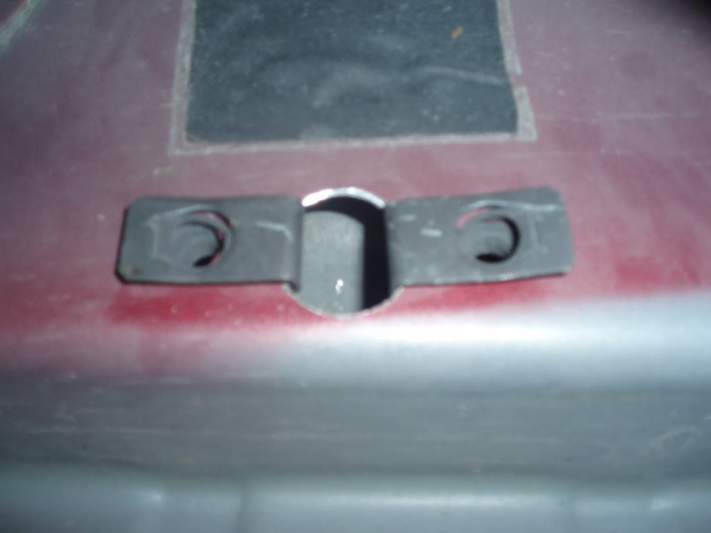

Question - so they had you drill a 1" hole to retain the "speed nut" bracket as shown in the pic. What I'm wondering about is the threaded "nuts" in the bracket just slip into the existing two holes? So when you tighten the mounting bolts what keeps them from pulling out when you hit something. It appears the middle bracket section that fits into your 1" hole is what is taking the load or is there something on the back side of the speed nuts that compresses like a rivnut and clamps itself to the sheetmetal?
If what I'm seeing is correct, I'd consider dimounting the step, painting the bare metal, taping/sealing the 1" hole and using some rivnuts in the existing oem holes or accessing the existing oem holes from the upper big oem hole after the tape is removed and using some fender washers and nuts from the inside if there is room for your fingers.
Just my .02, spend it anyway you want.

I don't know what Rivnut your referring to, but when I added the Amp Research Power Step to my truck they supplied "Nutserts" that had the same size hex on them as the ones in the body and they fit into the existing hexagonal hole. These went in and seated very easily.
These are fairly large bolts and a Rivnut that large would be difficult to set. The Nutsert just sets with the size bolt that your using....Very easy!

BK1 - Sound like you had the right part of the job with the nutsert's matching hex section fitting into the oem hex hole. Very nice.
Rivnuts come in smooth round shapes with or without splines to fit round holes and use a tool to compress them although there are ways around not having the tool which uses a nut on the back side - just don't put a twisting motion or torque on the rivnut when you tighten and clamp it. The hex does that for you.

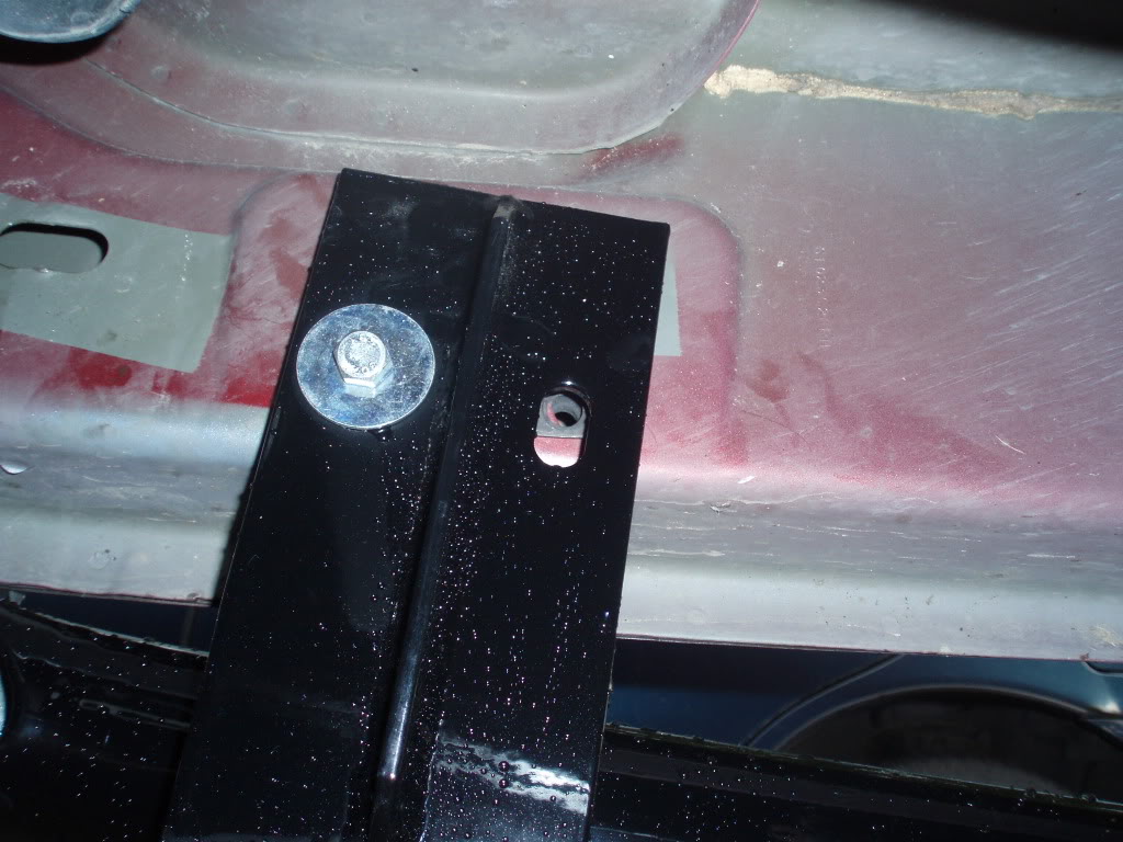

Are those Grade 2 bolts that they included, or just one you were using for mockup?
