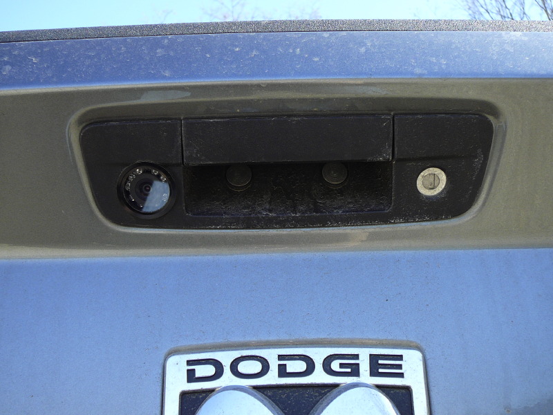

The camera is a standard CCD keyhole camera with Infrared capability for night use. They are available all day long on eBay for $65-$100. The GPS is a Garmin Nuvi 5000. It has a yellow RCA Video IN port. One of the features of the GPS is the ability to show the video IN picture instead of the navigation picture, and you choose how it decides which image to show. I have mine set to display the backup camera image whenever the image signal is present. In order to get power to the CCD camera, I tapped into the reverse light wire. When I shift in reverse the camera gets powered up, it sends a signal to the video IN port of the GPS, and the GPS switches over automatically to that image.
I also drilled a hole in the dash of my 2 day old truck, directly behind where I have the GPS mounted on the dash, so that I could run wires for power, video in, and the external antenna and not have any wires show from the drivers viewpoint.
I've linked to a couple of pictures of the camera installed into the tailgate handle, and of the image seen from the camera. The image I see is much clearer than what it appears in the picture. There was a lot of glare taking a picture of a picture.
