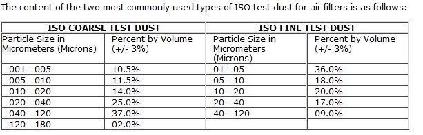

That's nice, but on average, a sand particle is about .05mm-2mm (50-2,000 Microns) in size.
What is a K&N filter rated at?????
Let's see....
So if you look real close, on average, the majority of FINE air containment is 1-5 Microns in size and an oiled filter is capable of stopping that. Sure, if you're going out to the dunes or something like that, then paper is the only way to go, but don't think that an oiled filter is junk because of what some people have to say about them.
