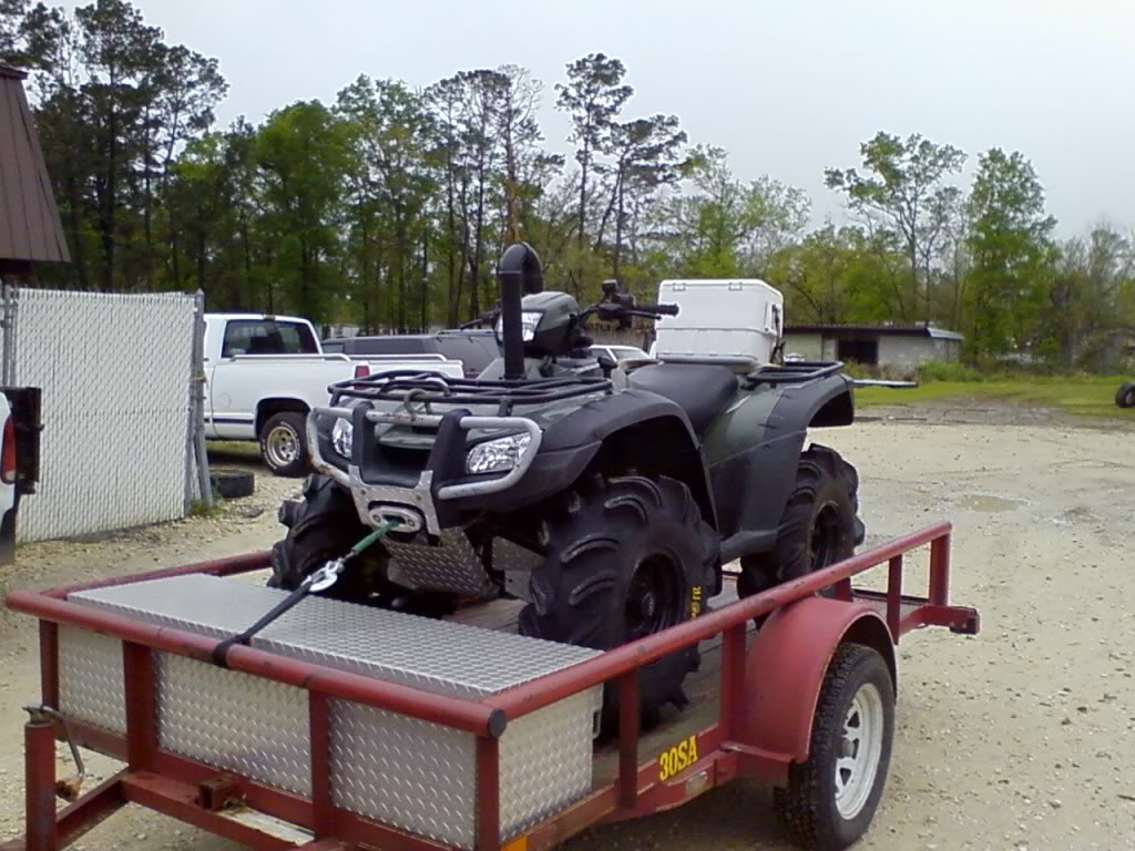

before i bought my truck i used my work truck(06 reg cab f250) and i could keep the 4 wheeler about center over the axle which is about a foot off of the tool box but with my new truck it seems that its to far back and makes the tongue alittle light in which now i suck the 4 wheeler all the way up to the tool box and she pulls just fine
