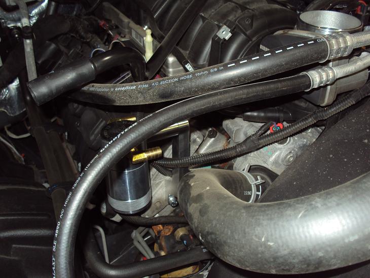

Got home and dug up my pics. This is the bolt hole in head used to install BT can. The cover will fit when the can is installed this way
