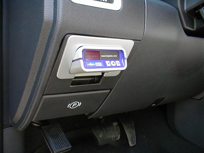

Ok so I have the 2010 CC with a build date on 9/09 and only have one plug. I was looking at an after market install in the same spot. I would prefer a factory install but dont feel comfortable splicing wires. Does anybody have pics of their aftermarket controler in the cubby. Thanks

Supposably they are coming out with a kit for those missing the wiring. My guess is that is just a regular old controller that fits the cubby. But when is anyone's guess.
Got tired of waiting and did this with mine.
