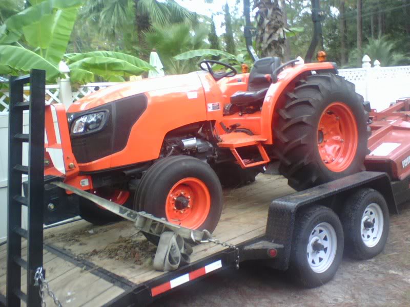

Yeah, that "squirmy" feeling takes some getting used to. I pull a trailer with a tractor and rough cutter on it every couple of months to cut some fields on my hunting tract.
Last time we did it we took a buddies '09 QCSB Hemi 4x4 out to the farm mainly because we wanted to compare how it towed. The back end sat very low (and the tongue weight was well within spec) and I drove and felt like I was kinda battling the truck the whole 28 miles traveled. I commented that if I had to pull that kind of weight with that truck for a few hours, I would be quite fatigued.
I've pulled that load with my truck dozens of times and also a couple times with another buddies Ford F150 and never feel like I'm fighting the load.
