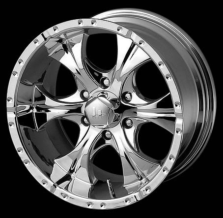

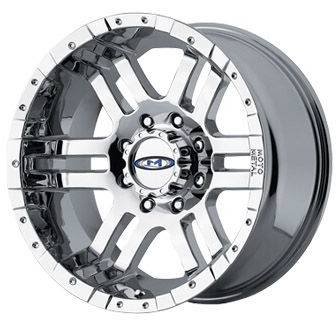

Well after going back and talking to them again, they checked and rebalanced the wheels and then I test drove it with the mechanic in the truck. At 50 mph, I let go of the steering wheel and it shimmied so bad he was like "why in the hell is it doing that?" So we told the manger and now I get to choose a new wheel. I didnt mention the part about specific wheel spacers to them.
The current wheel is a Dale Jr model DJ708 in chrome and it is a +20mm on the offset according to the tech.
So how much offset should I make sure the new wheel has? They are telling me the 0 will work the best without kicking the tire outside the fender but I figure someone else here might have more knowledge about the offset or no offset than me.
The first offered me the XDRockstar in chrome but, I told them I didnt care for that wheel. So they emailed me two other options to go for.
Opinions please.
Moto Metal 951
Helo 791
So anyhow, now I just wait for a reply with more options and of course I have to make sure the price point is the same as the DJ708 wheel.
Thanks
