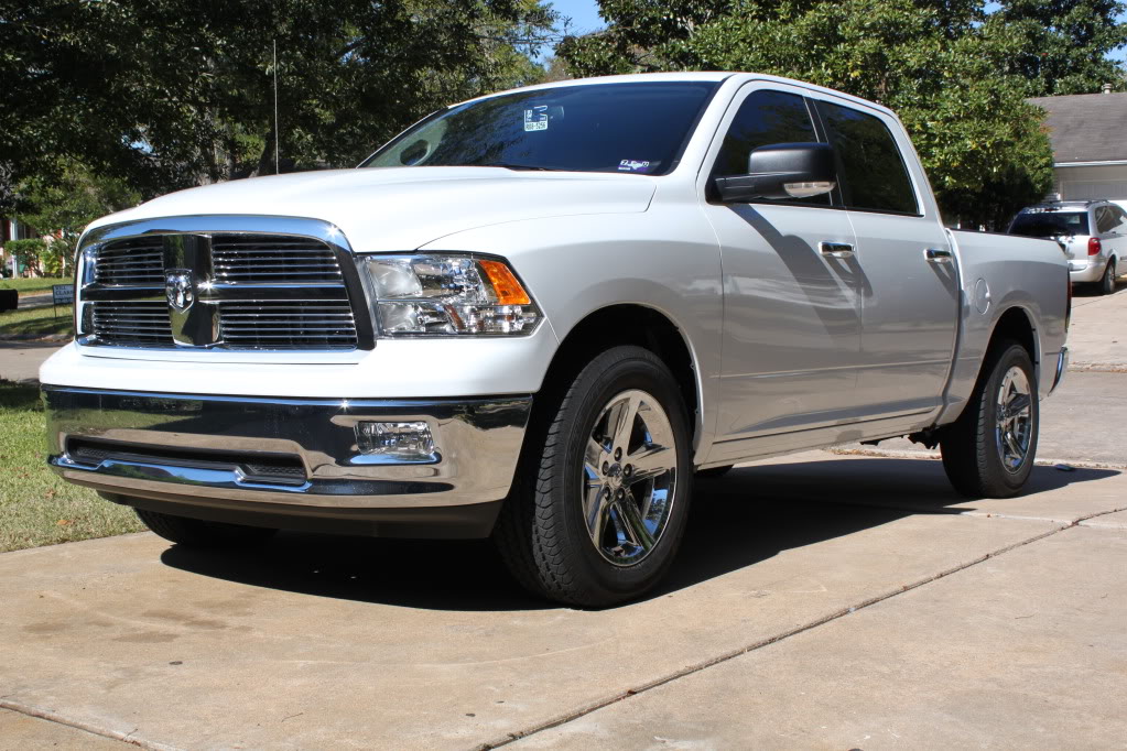

heres my truck as it sits..

Thanks for the reply. And yeah i know u can offroad a 2wd lol. I would need more then 1.5" to sit level. And do u have pics of the one leveled on 35's? Id want to run 35x12.50 mud grapplers. I dont really do off roading. But i go off road to ger places. Not gonna wheel it.
Don't want to burst your bubble but your not gonna be able to get 35"s under a 2wd with just a leveling kit. It has been done yes, but it will rub and it will look like the tires are stuffed under the fenders. Its only happened a few times but if I crank the wheel hard enough on mine I can rub the tires.
