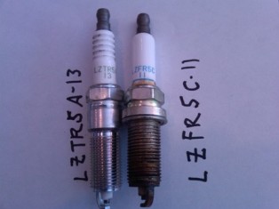

I've been trying to find some reasonably priced copper spark plugs for my '09 w/ 5.7, It wasn't as easy as I thought. The OEM plugs that came on my truck are NGK LZFR5C-11. This is a dealer-only part number, there is no NGK stock number, so you can't yet get these at your local parts store. These have changed from the previous years ('08 etc) as they are a colder plug. If you go to Federal-Mogul's website, the Champion part number that comes up is REC12MC4, stock number 446. But nobody has this plug, can't find it available anywhere.
Denso's site gives K16HPRU-11 as their part number, stock number is 6076. They are around $5, roughly same price as the dealer.
These plugs have all have the following heat ranges: NGK=5, Champion=12, and Denso=16. The '08 and earlier hotter plug has heat ranges: NGK=4, Champion=14, Denso=14.
NGK 4306, or LZTR5A-13, is a 5/8" hex, 14 mm thread, 1" reach, heat range 5. Those are the same as OEM, however, the "-13" signifies a .052" gap (as opposed to .044") , and the "A" specifies a different firing end construction, not sure how much that is an issue. This particular plug has been used quite a lot in DC engines, even spec'd as a colder plug on '08 and earlier 5.7 Hemi's. And although not an exact application, once re-gapped I think is a good fit. They are around $2 and available almost anywhere.

So I found some online for $1.99 at Advance, then had a $10 off coupon, plus my bank card gave me 5% off. So I ended up paying like $20 for a set. But the LZTR5A-13 did not work. They are for a tapered seat and the stock ones are for a flat seat with a washer. So much for trying to save a buck.....
