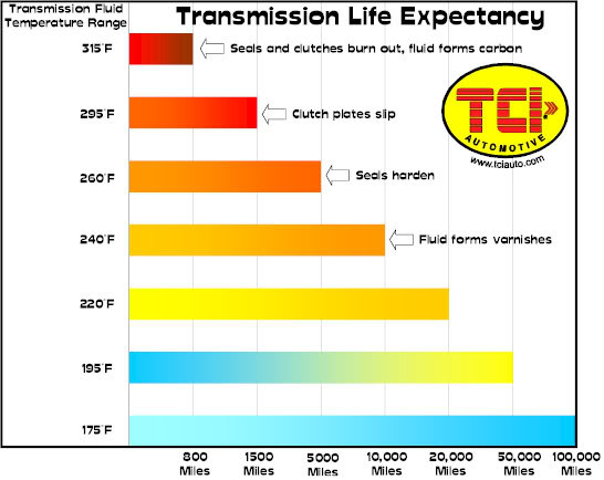

I've had the air lift bags for about five years now, obviously different since I have rear leafs. I will also use a WD hitch when pulling over about 6000 lbs. Bags are a good investment.
As far as the tranny temp goes, I kinda like this simple chart:
As far as by-passing the trans cooler when in OD, I've never heard it, but I'm curious now and I have a couple of different sources where I can find out. I'll post back...

There is a thermostat on the input line to the trans fluid cooler, I would think that the only time the cooler is bypassed is when the fluid is too cold. My experience with the fluid temps and OD is that in tow haul mode versus not, the temps don't vary much. Tow haul does allow the first OD though. I've monitored the trans fluid in 3rd gear and I don't remember it making a difference either.
