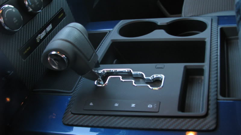

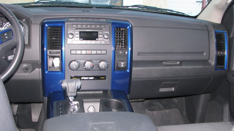

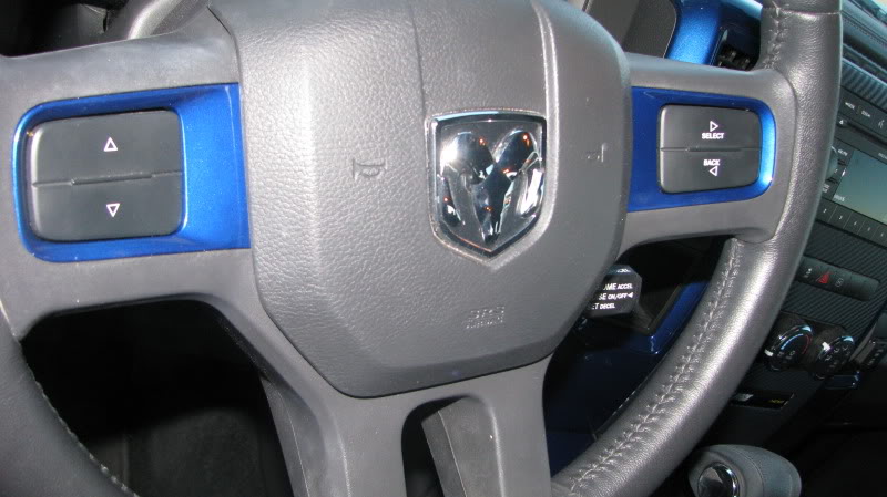

Painted my interior parts & installed some Di-Noc yesterday would love to post some pics but how do you do it my pics dont have a url they are just in folders. jpeg images.http://i76.photobucket.com/albums/j1...2/IMG_2609.jpg http://i76.photobucket.com/albums/j1...2/IMG_2596.jpg http://i76.photobucket.com/albums/j1...2/IMG_2601.jpg

Quick question, the piece that goes around the shifter console. What did you get to cover it? Where did you get it, and could I only get that one piece?

It is 3M Di-Noc its a adhesive vinyl carbon fiber it even feels real once its on! you can buy it off ebay that is where i got mine and you can look up install tips on you tube! make sure you get the adhesive promoter with it works alot better!

You can search the threads here for removal of the face plate and center console there are some good threads on this already! the buttons on the steering wheel are easy to remove just push over on the horn/airbag a little and work the plastic surround up at the outer edge first working towards the center of the steering wheel! Make sure to dissconnect the battery first before doing any of this work! I used automotivetouchup.com for factory paint color and clear and adhesion promoter for paint.
