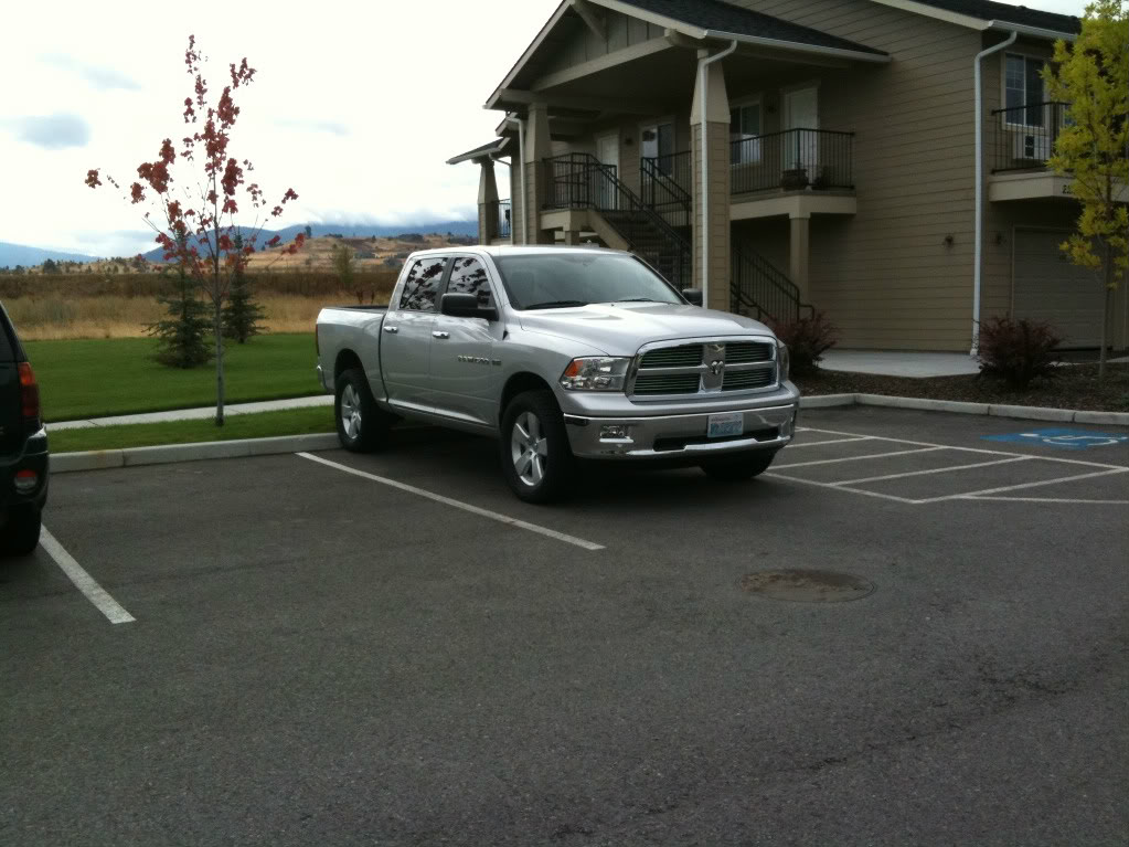

a leveling kit will raise it up, and they're very affordable. you can remove the lower air dam as well, though it looks better on IMO. here's a pic of my truck with a 1.5" leveling kit, which is about the smallest you can get. most people run a 2" or 2.5" kit.

More than likely, it's aerodynamics for greater fuel efficiency. Lift the truck, take of the lower valance, etc.. These are your main options

there's two different ways to do it: with strut spacers or with adjustable shocks (Bilstein 5100's). here's a link to the strut spacers i used (with a pic to give you an idea): http://www.topguncustomz.com/Store/G...view=250190010
that's just one of many leveling kits. what's shown in the pic is exactly what you get in the box and the only parts needed. they look like they're very easy to install and most people do it themselves, but i payed a shop just because i didn't feel like doing it myself.
couple of things to note: you have to get an alignment after it's installed since your wheels will be out of camber. and it could potentially void your warranty on some of the front suspension components (ball joints etc.) if something fails and it's determined to be caused by the leveling kit. also some people experience 4WD vibration after a leveling kit is installed. but that's a common problem even for stock trucks driven directly off the lot.
