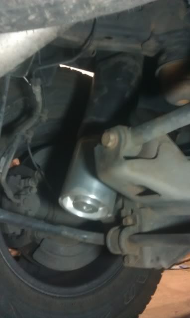

I'm only running the rear springs though. I think a lot of it has to do with some incorrect information from the tech department before ordering. I asked if it would run at stock to two inches above normal ride height and I wanted to tow my trailer.. They said yes. It does ride at this height. However, when you put a load on it the springs are at just enough of an angle to shoot them out with the added bag pressure and side load from the springs being at a slight angle.

Just some pics and info on the ridetech kit.
How it sits in the lower spring perch.

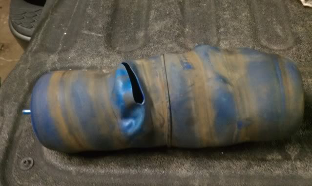

How it looks aired up to what I want it to ride at unloaded(I'm running it 2" lower just to keep it from coming out but even at that height they came unseated with the trailer hooked up)

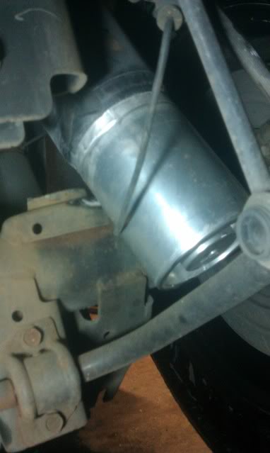

How they look when they fly off.

An exploded Firestone bag......just for fun. I only had 40lbs in it at the time so I really think something hit it because I was just hauling my open trailer and buggy at the time.

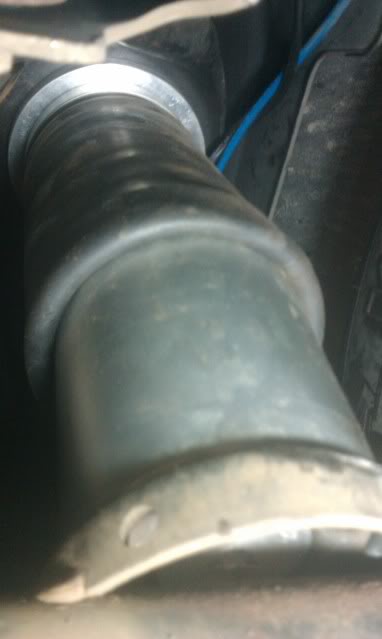

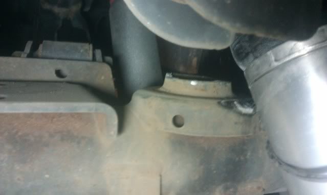

Still playing with the tow rig.
Had the shop fix the leaking rear pinion seal, exhaust manifold bolts(again), muffler clamp that was bad, rod ends that were recalled, and a few service items.
09 1500 Ram with 96k on it. Lots of it towing. I've been happy.
I pulled the RideTech kit.
Put the Airlift Bags back in the coils. I can finally drive it without being white knuckled all of the time.
At no point in the stroke of the suspension, did I feel like the angles were right with the RideTech kit.
