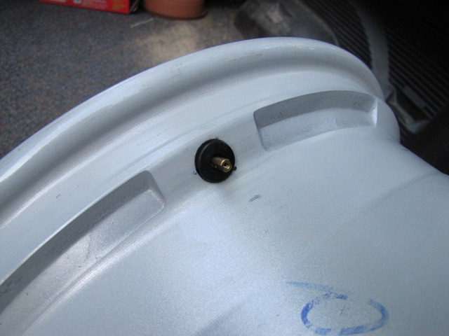

Now a question. I got those 4 rims, from an Express, off of Craigslist. ($400.00) So the ad said it had the sensors, but when I got there they were not on them. They did have the valve stems. Now....Do I need new stems or can I use the ones currently on the rims without the sensors...Here are pics
Do I need the sensor on it to make it work or will it hold air like it is?

I wouldnt trust it to hold air, at least put some new non-sensor rubber ones in if you`re just using them for winter.
In the 2nd picture, looks like to me they broke the sensors off (???) likely when they removed the tires. New sensors will have to be programed to your truck. I believe if you install a set of wheels from another truck, those will have to be programed to your truck as well. I went thru this myself last year when i bought a spare set of steel wheels for the winter tires for my truck. Now, if you put just plane ole rubber stems in, i`m sure you already know that the TP monitor warning light will always be on.

Yup, thats exactly what i did. I`ve heard people say that you can shut the TPMS light off if you have a superchips programmer. I cut a really dark piece of window tinting film and placed it right over the TPMS light in the dash. It stays clung to the plastic dash panel really good, so thats keeping it from annoying me at night when i drive. Then when spring rolls around, i put my 20 inchers back on, the TPMS light goes out immediately.
