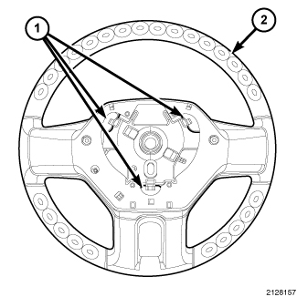

NOTE: It may be helpful to use a small mirror to aid visibility during the initial attempt to remove the driver airbag from the steering wheel. 4.There are three airbag retainer access holes (1) on the instrument panel side of the hub of the steering wheel (2), located at the two o'clock, six o'clock and ten o'clock positions. The steering wheel must be rotated to bring each of these access holes up to the twelve o'clock position of the steering column one at a time for removal access.

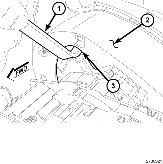

5.Insert the short blade (Tip A) of the Driver Airbag Removal Tool (Special Tool #10187) (1) or the blade of an equivalent prying tool into either of the upper (two o'clock or ten o'clock) access holes (3) of the steering wheel hub rear trim cover (2), being certain to place the blade of the tool on the inboard (steering wheel hub) side of the airbag snap retainer wire loop.

6.Push the handle of the tool downward for the blade to pry the snap retainer wire loop (3) upward far enough to disengage the loop from the hook of the steering wheel armature. At the same time, gently pull the driver airbag (1) away from the steering wheel (2) to prevent the retainer from snapping back into place over the hook once it is disengaged.7.Repeat Steps 5 and 6 at the other upper (two o'clock or ten o'clock) access hole to disengage the other upper snap retainer wire loop.8.Repeat Steps 5 and 6 at the lower (six o'clock) access hole to disengage the lower snap retainer wire loop. The lower snap retainer wire loop has a distinctive V-shape and must always be installed onto the six o'clock hook of the steering wheel armature.

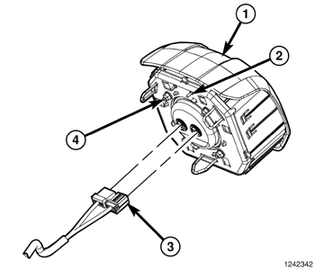

9.Pull the driver airbag (1) away from the steering wheel far enough to access the electrical connections (3) on the back of the airbag housing.
CAUTION: Do not pull on the clockspring pigtail wires or pry on the connector insulator to disengage the connector from the driver airbag inflator connector receptacle. Improper removal of these pigtail wires and their connector insulators can result in damage to the airbag circuits or connector insulators.

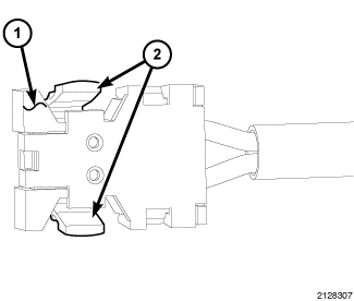

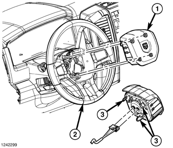

10.The clockspring driver airbag pigtail wire connector insulators (1) are secured by integral latches (2) to the airbag inflator connector receptacles, which are located on the back of the driver airbag housing. Pinch both latches firmly, then pull the insulators straight out from the airbag inflator to disconnect them from the connector receptacles.11.Remove the driver airbag from the steering wheel.12.If the driver airbag has been deployed, the clockspring must be replaced and the steering column must be inspected.
