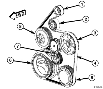

I had the same thing, the dealer listened ,and after i told them it was the top pulley , they replaced the P/S pump, pulley and belt anyway, I have since changed out 10 of these for my buddies, it turns out on ours it was the pulley facing the engine at the top,#2 in the picture, it sounds just like the p/s pump, but it was not, the pulley is 15.00 at Napa, with the belt tool takes about 10 minutes, loosen the bolt with the tool , release the tension remove the pulley and reverse.....its was not the tensioner on ours it is was the other pulley, I changed mine in 2009....still great today,

Thanks already replaced the pulley that you indicate and the idler assembly still have a squeak somewhere.
