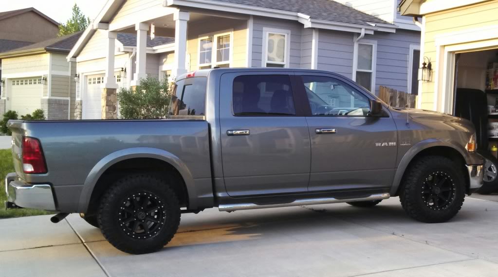

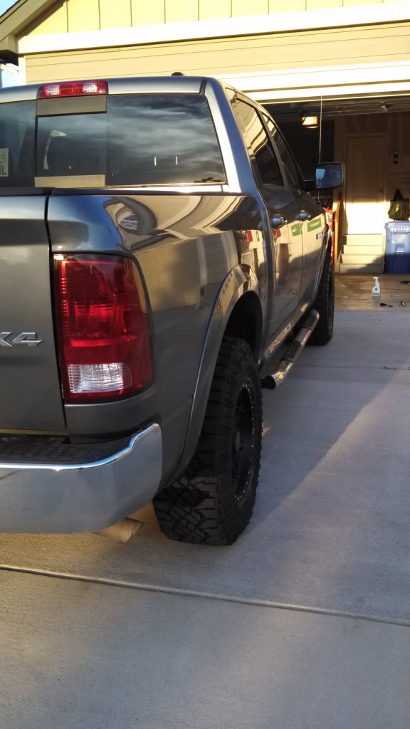

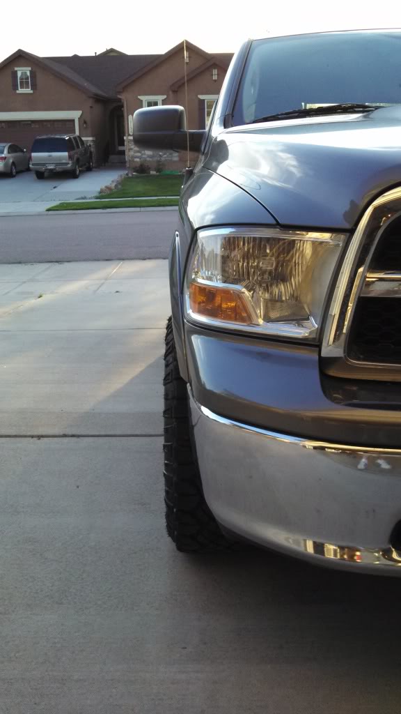

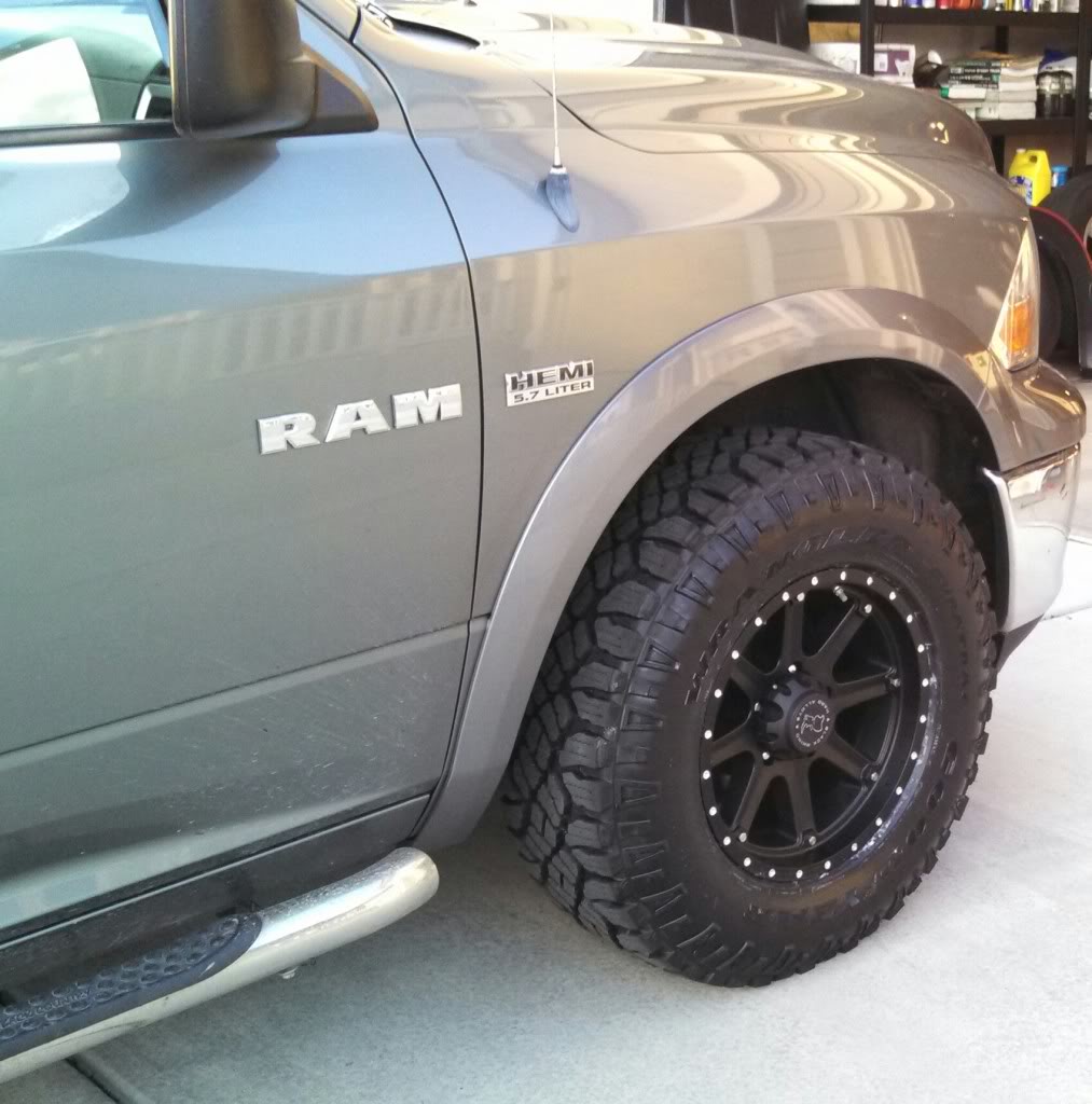

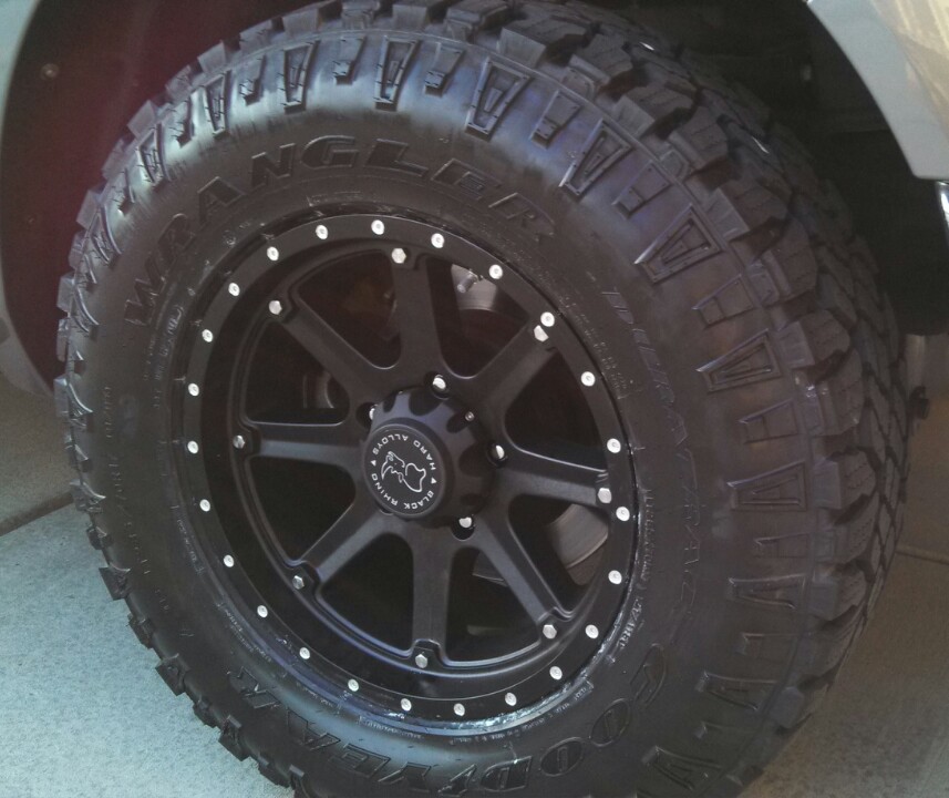

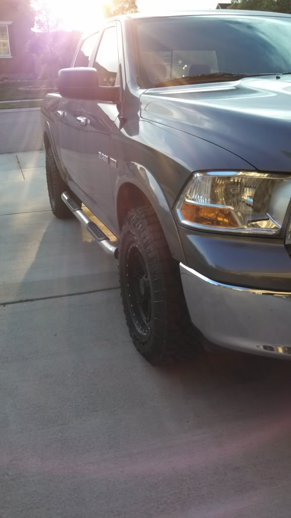

Well, here is how it turned out.
285/70/17 Goodyear Duratracs
17x9 Black Rhino Moab wheels, 0mm offset, 5" backspacing
No rubbing at all, plenty of room. I'll still be doing the Mopar 2" lift (Bilsteins in the front, new coil in the rear), but it fits fine as is.
