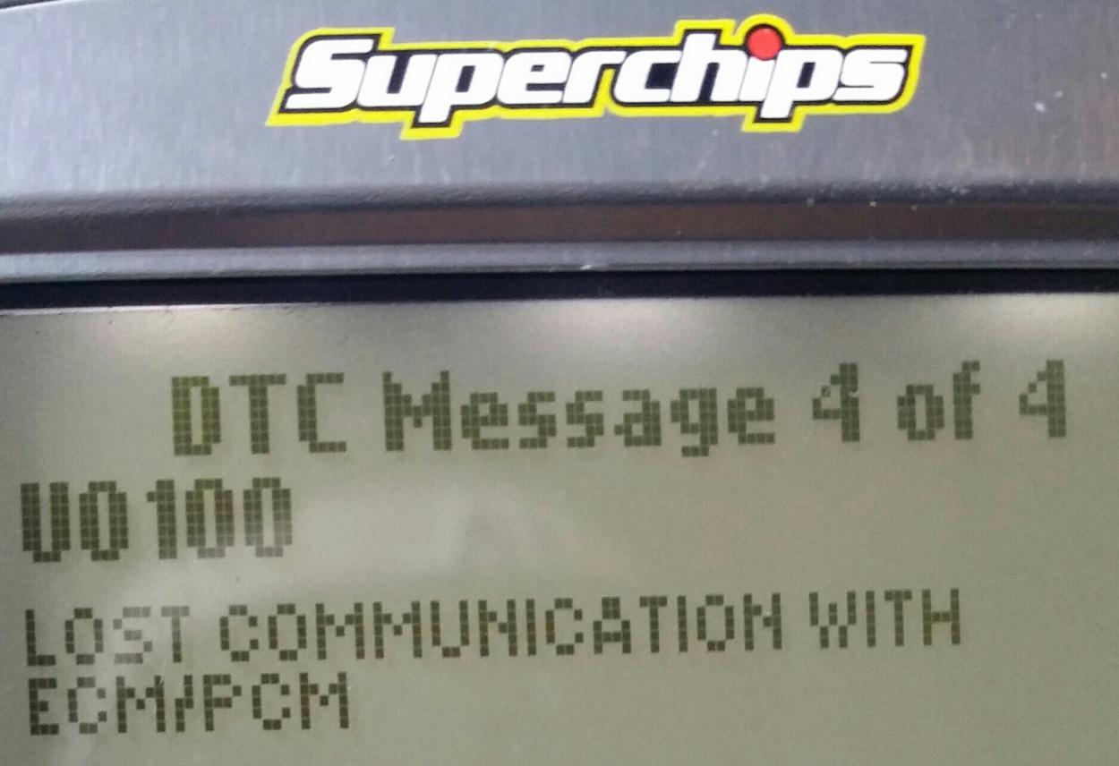

My truck is throwing code U0100 code. Didnt pass california smog test. I found a post of a bully dog user that had same code, which only appeared when he had a tune installed. Can one of you check for dtc codes just to verify if this is correct. TIA

Remove your tune and return to stock tune. Drive 60 or so miles or wait for the check engine light to not flash with the key on after 10-20 secs. Smog. Then re-tune.

Cool. I already removed tune, hopefully i can get some miles in this weekend so i can get rechecked on monday. Gettting ready for a road trip, i would hate to take the honda instead of my truck! Lol
