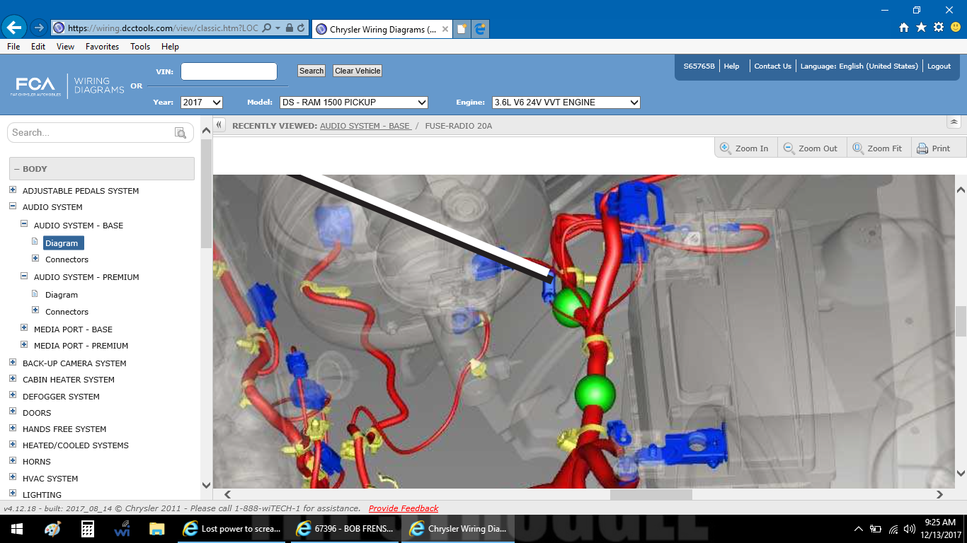

There is a separate fuse for radio. It's inline to the rear of the fuse box.... NOT in the fuse box

I checked inline fuse.first thing i checked.
