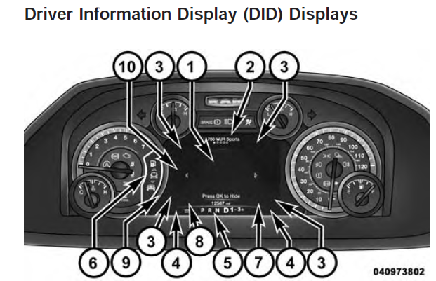

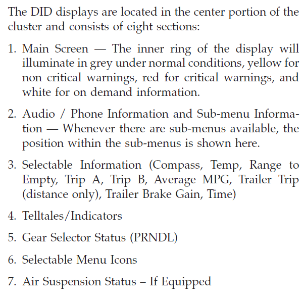

I opened the PDF of my owner's manual and assuming you have the Premium Driver Info Display (DID) cluster, then these are the only options available (tranny gear isn't one of them).
I do have that display, and if you look closely at the 'gear selector status' (#5) you'll see that right next to the 'D' there's a 1 (current gear) and a 3 (maximum allowed gear) that is controlled by the +/- button on your shifter. There just isn't an arrow pointing to it specifically in this PDF.

I understand what you're asking. That is the answer that I gave you: the ONLY OPTIONS that are available/customizable are the ones on this page. The transmission indicator (in ERS mode) is only on/available WHILE IN ERS mode. The presence of the gear indication is the vehicle's way of letting you know that A: ERS is active B: the highest available gear you which to use and C: the actual gear the truck is in.
No way to make ERS permanent upon start - this is an automatic transmission that expects to work automatically.
