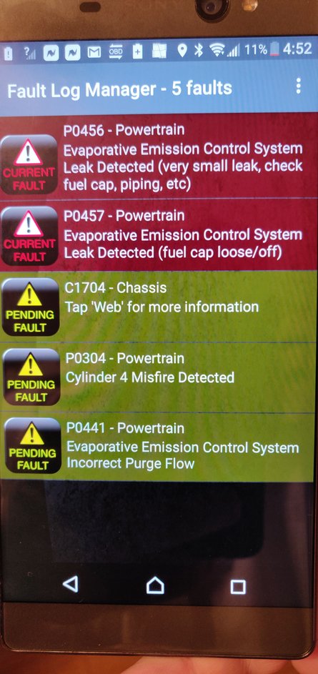

Hi,
So now I just got it back from its oil change and new tires put on. I am going to post the Torque Codes now. The miles are 72,000. I hope the information I provide is helpful
Spoiler
Spoiler
Thank you for taking the time to review the log. Now the codes are different from earlier. No engine light on now, but correct me if I am wrong but it seems now to be pointing to all the EMISSION based items. Also I found a hose that looks a bit odd and it looks like someone cut this hose. Here is a photo below.
Looks like a cut hose...not sure what its trying to go to.

Update : So I was reviewing some of the other forums, and they said to disconnect the positive battery cable. I did this and the gas cap notification disappeared. I am not sure if this is a band aid fix or is this a perm fix?? Your help is appreciated.
