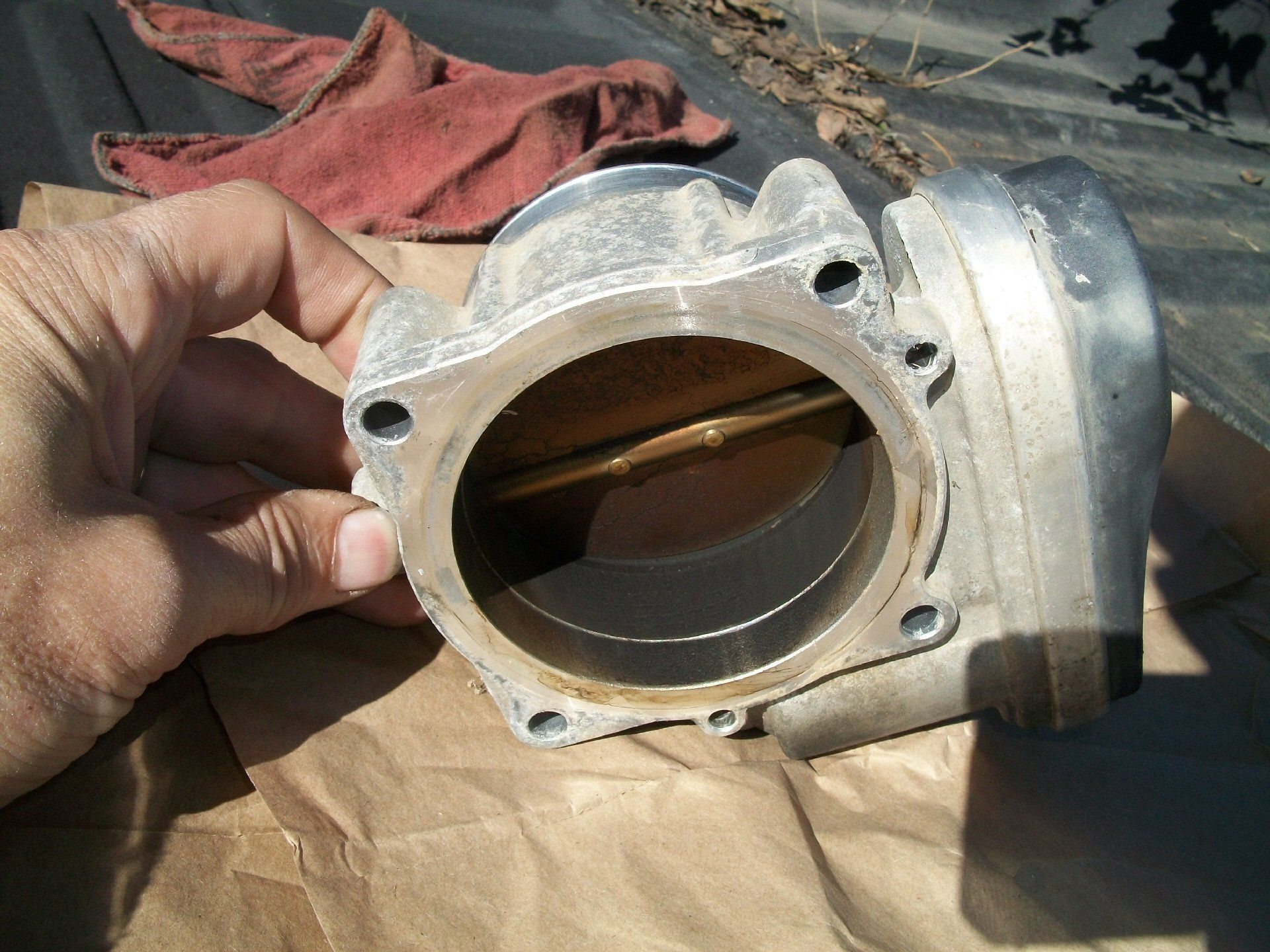

So, during my internet snooping, someone said to make sure the throttle body wan't gooked up from the PCV system (yes, there was a lot of gook in it, and the manifold, and intake runners of the heads, and intake valves.....at least to me it's a lot). I cleaned the throttle body & took it for a longer drive today. It runs well, but I still have a blinking ETC light, along with a traction control light, and the check engine light. The acceleration is good, the idle is good, the cruise (at 45mph) is good. My appointment with the shop is Tuesday morning (to re-charge the AC and check these error lights). Yes, I have been trying to snoop around to see if I had something pinched somewhere.
When I was taking it apart, I couldn't get the gadget on the back side of the manifold to unhook (there's not enough slack in the wires to pull the manifold away from the firewall to get a good grasp on it). I wound up cutting the wires & I made a longer patch of wires (there were 4 wires) with bullet connectors. Next time, if ever, the manifold has to come off, I'll be able to pull the manifold 10 inches away from the firewall to get at that connector.
Does anyone know what that sensor is on the back of the manifold? It could be possible I didnt' get a good connection on one of the wires maybe???
