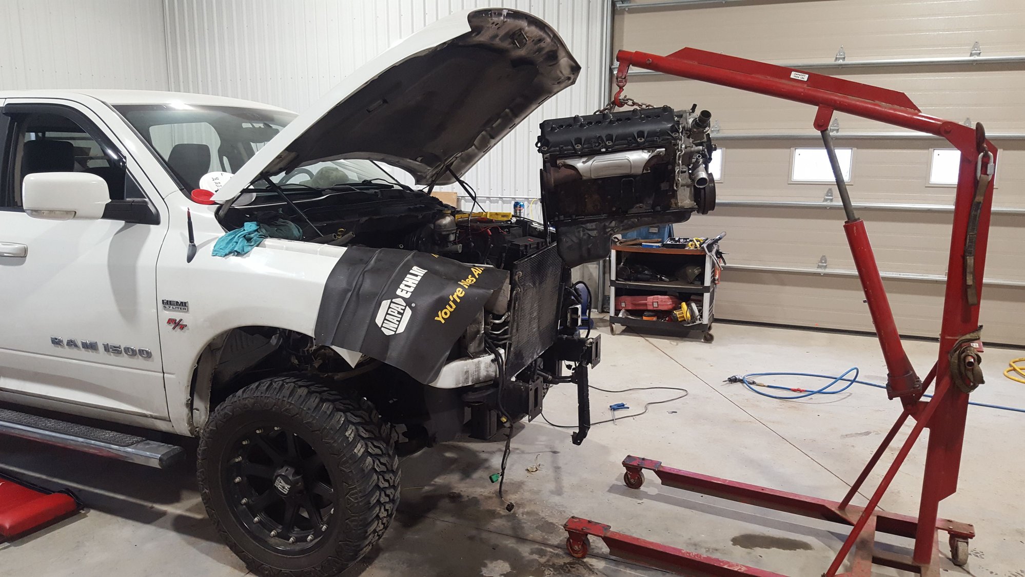

Hi Scott. Just finished a repair on my nephews 2011 with similar km. See my thread titled Hemi Camshaft
Youtube MMX engine Hemi. Good info there. Would have liked to buy from them but shipping was outrageous to Canada. Nephew ended up buying off Ebay. EngineTech was the name I believe. Surprisingly most parts came in Mopar boxes. We did a mds delete which required the purchase of a tuner. Not many kilos on the truck since teardown and reinstall but so far so good. Here is the cam that came out. Feel free to Pm me if needed. All in all..engine removal teardown build and install went fairly easy and straight forward. There is also a youtube from Jasper engines about hemi removal which I studied a bit before tackling the project

Its a toss up whether to pull engine for cam and lifters. We decided to install a new oil pump which pretty much pushed us to pull engine.
Oil pump draws oil thru the sump where it is then sent to the filter and on to lubricate the engine. Figured alot of metal shavings went thru the pump and hopefully most caught by the filter. Our sump had a fair amount of metal shards stuck in the sump screen which we cleaned out. Small amount of gritty paste in the oil pan by the drain.
