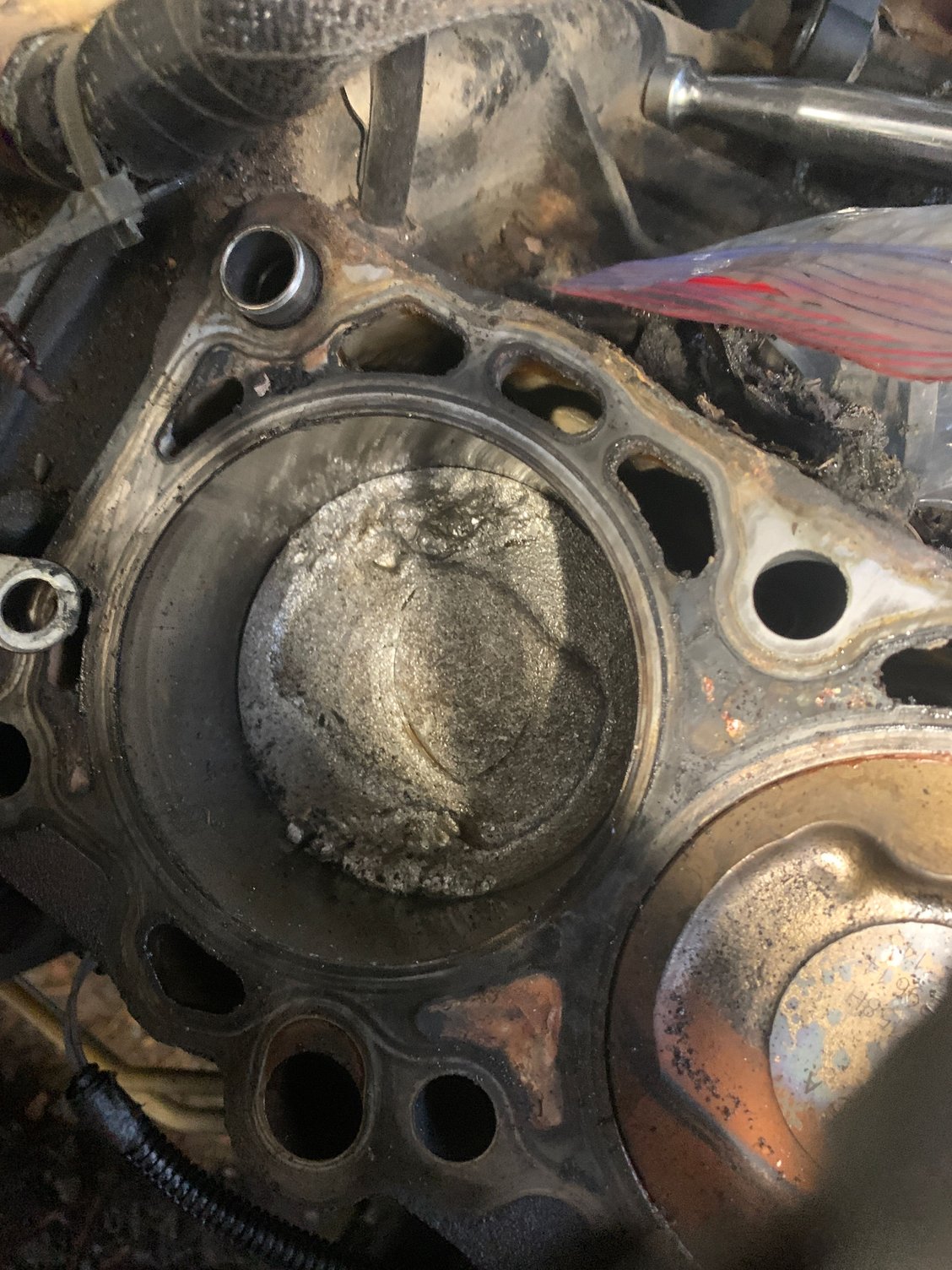

I pulled the head and it appears I dropped a valve seat. Now to determine if the piston and cylinder is salvageable.
This is the number 8 cylinder piston.

I would say that piston is done.

The same piston is dead, and what look like the head ? A photo ? I think that the rocker break and valve fell donwn. You can keep old spring and change seal only without plastic it's most cheap. I just do it on mine 4.7L. Look at seat valve if it's not destroy.
