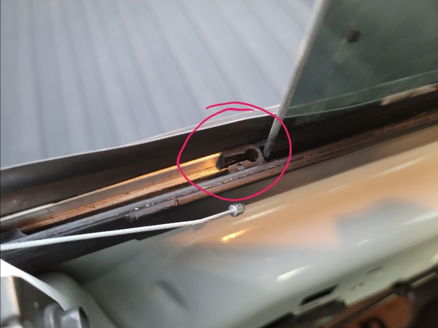

So I bought my sister's 2011 Ram 1500 Laramie because my 06 1500 was getting up there in age and mileage. I know I have a few things to fix on it and one of which is the rear power sliding window. I order the new cable and when replacing it I found out why it failed in the first place. On the passenger side of the sliding window the clip where the cable attached broke. I have found some info on getting a replacement track on a 2006-09 but nothing on the 2011. Does anyone have the part number for just the lower sliding channel?
