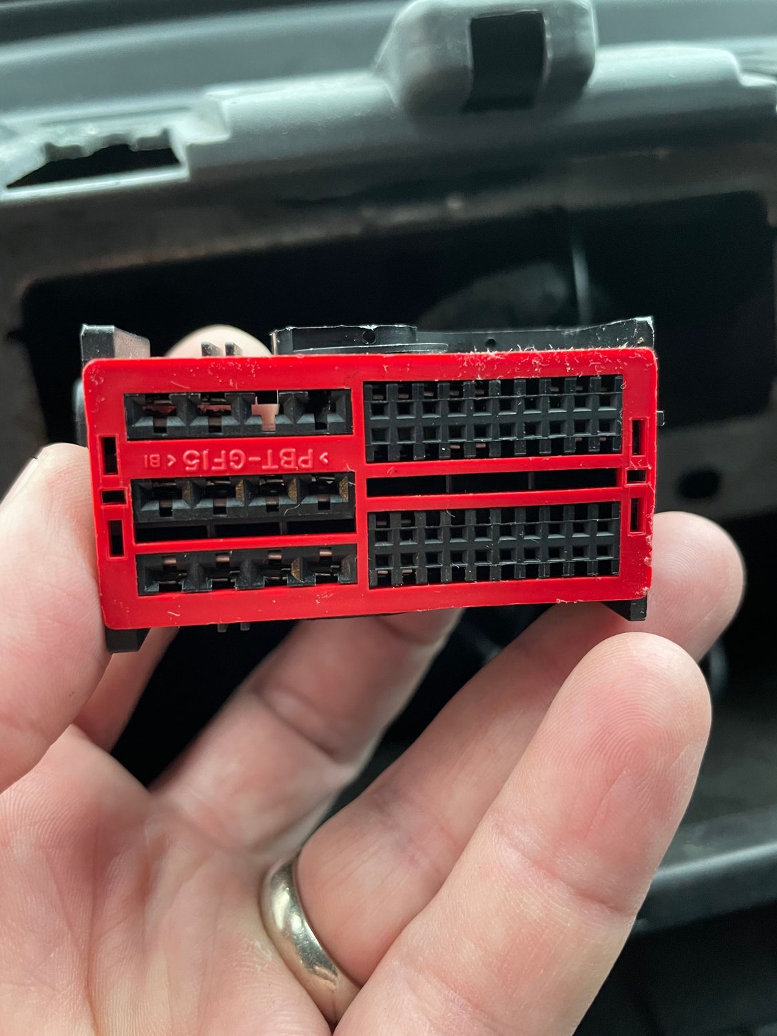

New to the forum. Appreciate any help on this one. Upgrading my factory stereo to an aftermarket double DIN. I’m 100% good on the mounting kit, but the harness I bought on Amazon is not correct. Not even close, I’m fact. Having a hell of a time finding anything that looks like it will connect online at Crutchfield, or anywhere really. I’ll put a picture up of the truck side of the connection in hopes someone can guide me to the correct harness!

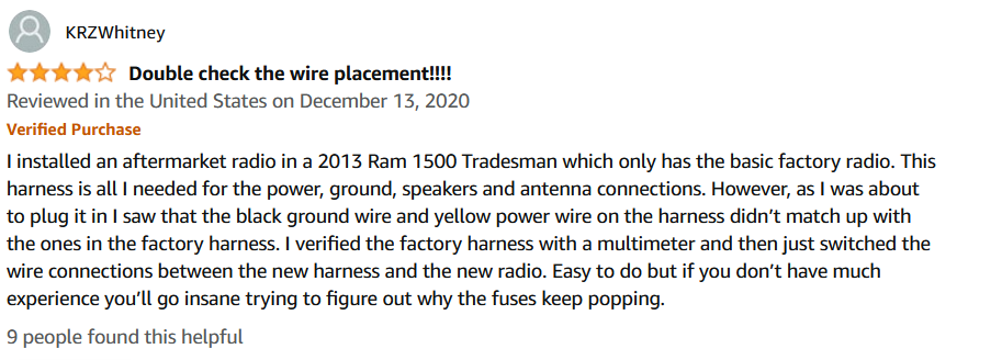

Amazon 2013+ Dodge Ram Wiring Harness Adapter Amazon 2013+ Dodge Ram Wiring Harness Adapter
Note that as stated in the Reviews, the Yellow and Black wires are reversed, do not wire them 1 to 1. swap black and yellow.
