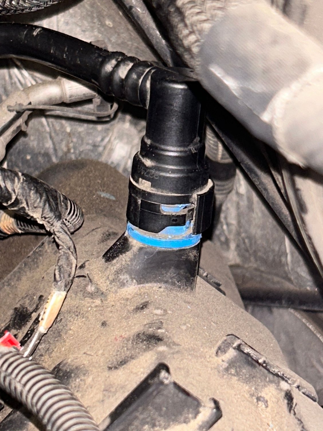

Good afternoon. I am attempting to remove my valve cover to replace the gasket after seeing oil in #7 spark plug boot.
My question is does the black piece that goes over the pcv valve simply push on? I have tried pulling pretty hard but figured I’d ask for assistance before breaking anything.

I Dunno, looks like a plastic clamp and if you squeeze it tighter, can release the hook.

I really think that clamp if you gingerly squeeze it with a pair of pliers ... while it compresses, the plastic hook will get loose and release.
There really should be no pressure in the crankcase and a properly working system on a older vehicle would never have a clamp on it .... not sure why yours does.
If the clamp broke I would just replace it with a standard worm drive or spring clamp .... the plastic clamp proves there is no pressure there .... why they even have it is beyond my thinking.

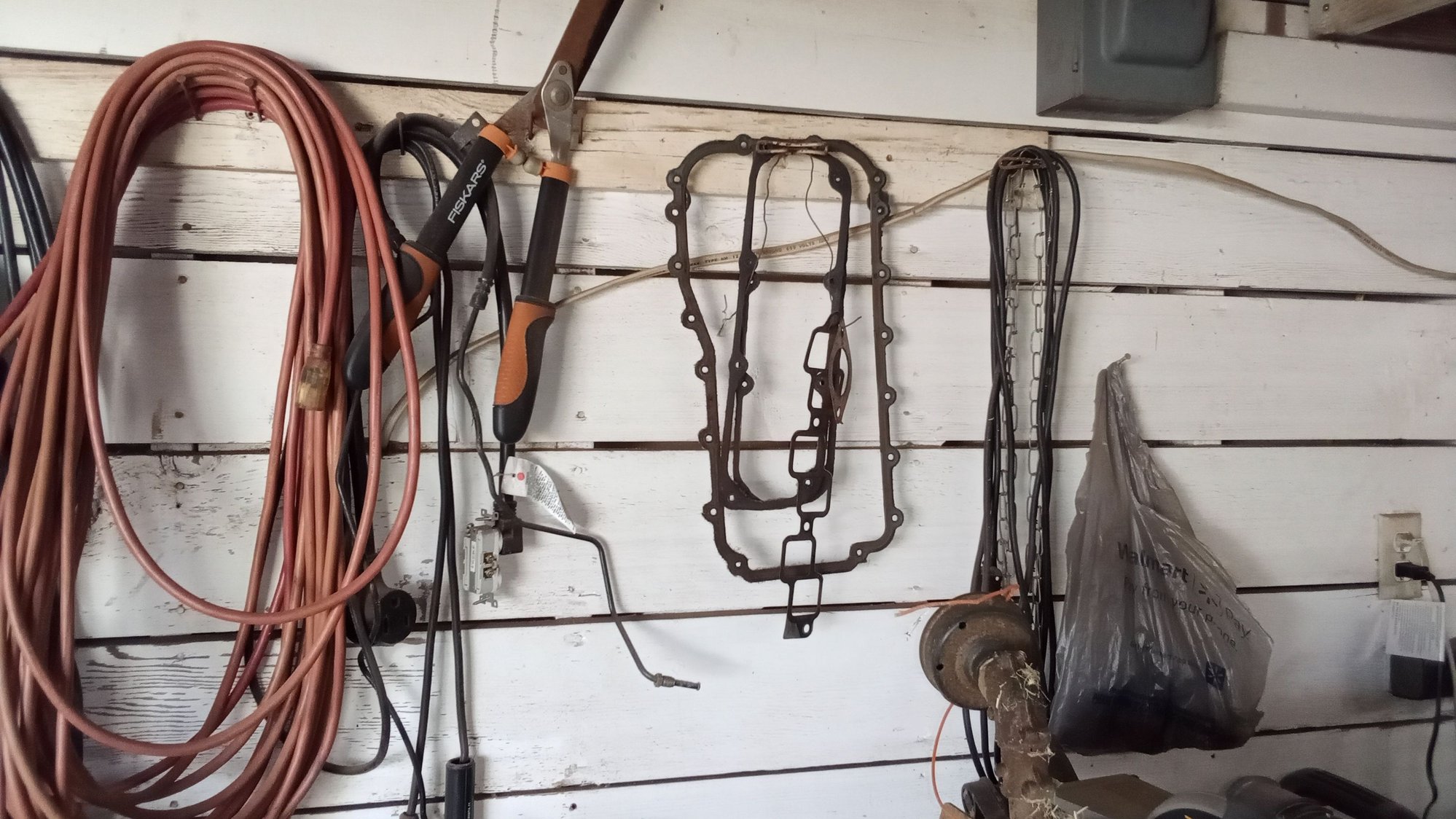

I'm just saying, I have a used set of gaskets hanging on the wall I would not hesitate to re-use. ... oil pan, valve cover, plenum, exhaust.
