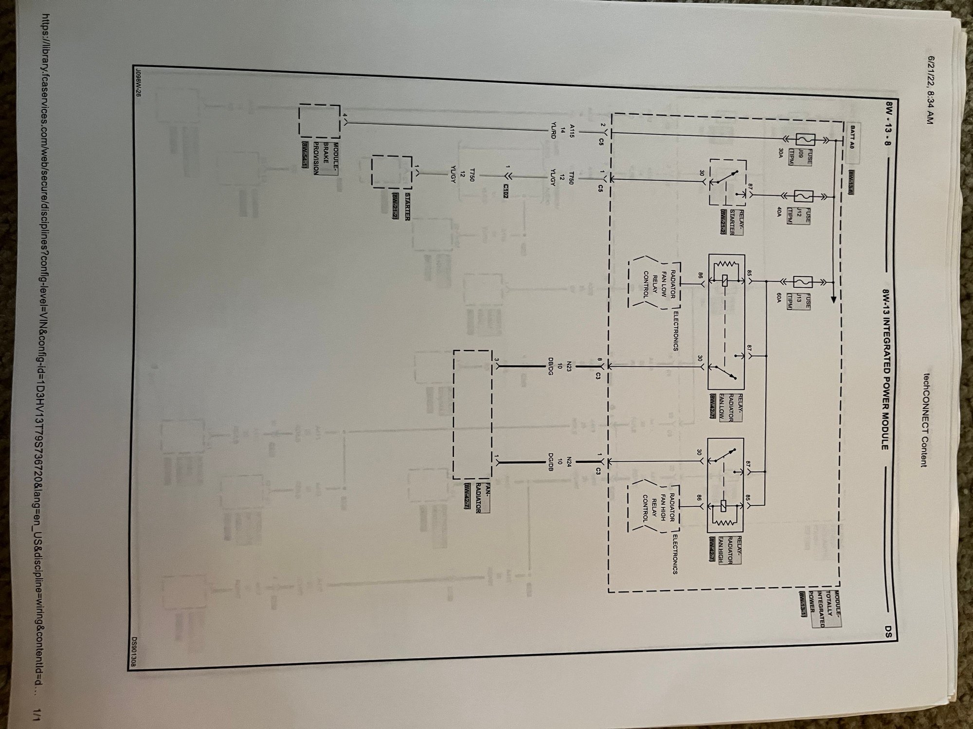

Old May 9, 2025 | 12:32 PM
w5jkx@yahoo.com's Avatar
w5jkx@yahoo.com
Joined: May 2025
Posts: 8
Default Radiator fan wiring for 2009 I believe they are the same
Originally Posted by Bkrupa
I have a 2012 Ram 1500 5.7 l just had the motor rebuilt replaced got it installed starts up find everything works but now the electric radiator fan will not kick on try to change the fuse the relay check the relay shows that it's clicking has ohms and everything even replace with a new one still not working I even hooked up the fan directly to the battery and the fan will kick on change the thermostat temperature still not working
