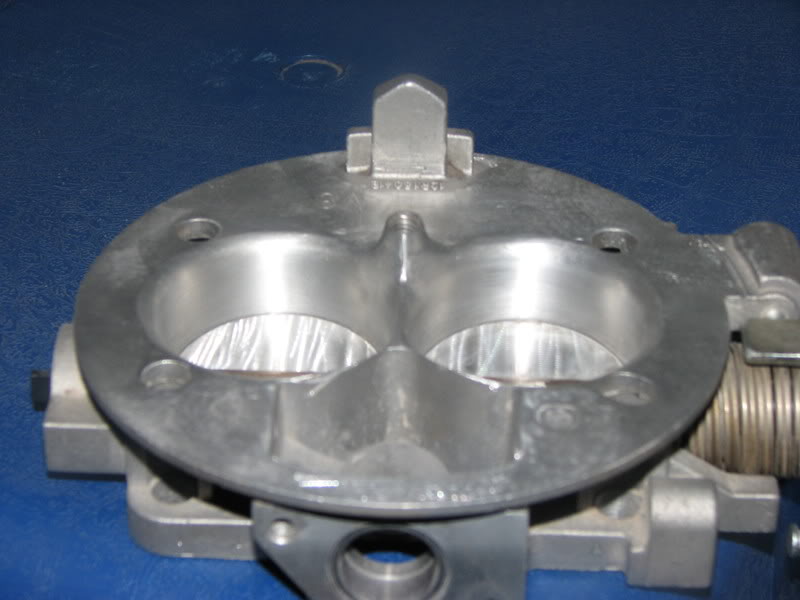

-V-8 TB - $80 Shipped - Air Horns removed, bored to full 50mm, tapered, Shaft is profiled, and it's been half-shafted too! This thing flows VERY well For the V-6 Guys for $20 extra I can make it so you don't have to change your cable.

do thay have stock throttle plates of did you make new ones
Stock 50mm plates.

well how did you get them to seal all the way around then
by being very careful while boring and adjusting the plate angle after reassembly.
