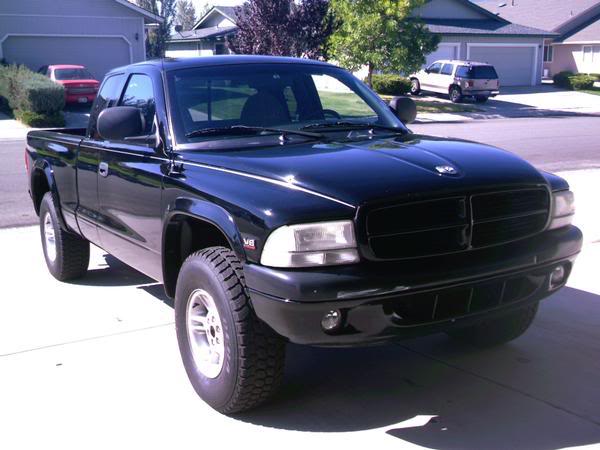

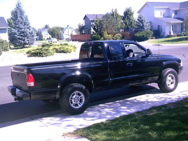

[align=left]Hello, I am trying to figure out how to take the rear drivers side panel off (That covers the speaker). Because the speaker cover has fallen off and makes the spekaer sound horrible as the speaker presses up against the cover, But I cannot figure out how to take the panel off to get to the speaker???
Thanks!
Here are two pictures of it to show what kind of cab it is. =)
