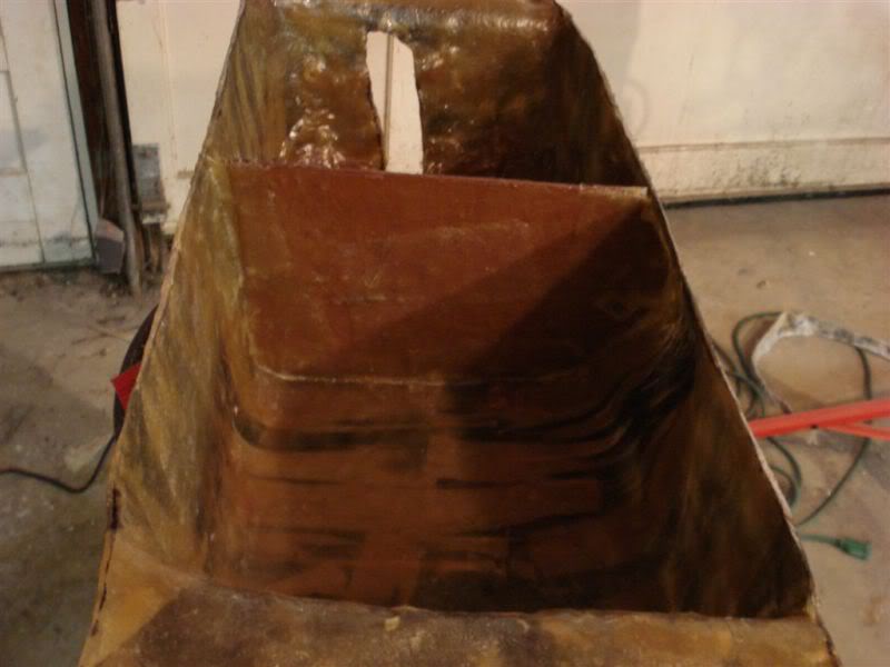

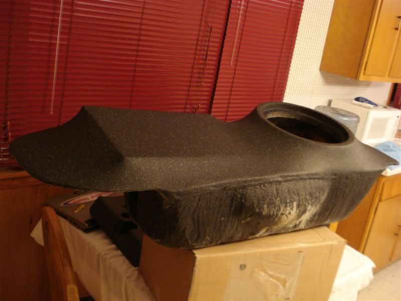

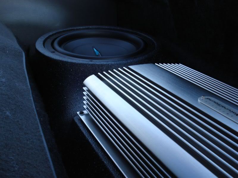

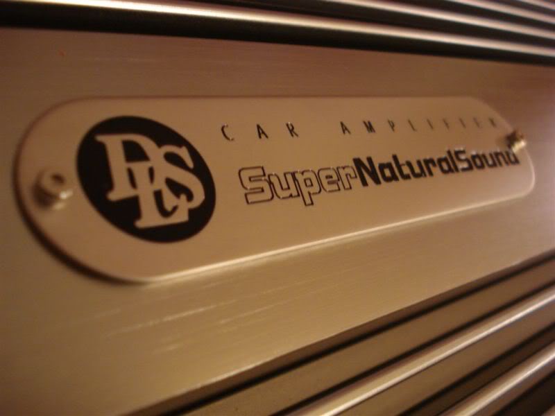

Well.......a month later I will update this....actually the car is up for the winter now lol. I will get some pics of the components up front, but they are jst mounted in the factory locationm so there isnt anything super special about them....and the radio isnt the one im going to keep in it. Overall im pretty happy with how it came out for my first big fiberglass install. The subs sounds pretty good and has great output for a single sealed 10". I could stand the speakers to have a bit more volume, but they sound pretty good. With some deadening in the door and a new head unit that would give me a bit more eq I think I could make them sound a bit better. Onto the pics....

Amp/Sub

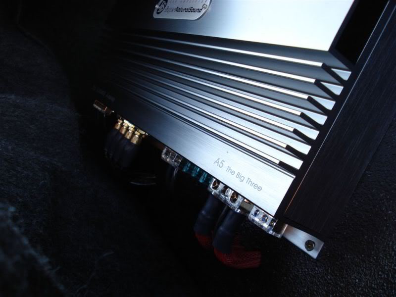

Nice build! I love seeing the amps and the wires all tucked in. Some people hide the amps undeneath plexi and I just think that's the worst thing for them unless your getting fresh air to them. The'll heat up like crazy. What did you spray the top coat with? It's almost like a speckled undercoating? Ofcourse the kind that would harden and not remain pliable...lol
Just one little picky thing.......does it bother the crap outta you that the amp doesn't sit flush on all 4 corners like you had hoped? I know it would bother me if I had spent that much effort on it trying to make it look perfect! Ofcourse things cannot always go perfect, but I was just curious???? It looks beautiful though. I did a similar set-up in my SS but the amp sat up top and got too hot from the sun(ended up tiniting the rear window after it was fixed) It was a PIA to keep the T-tops in the car with all that stuff. I ended up making brackets that went over the amp deck to hold them. I know I have a pic somehwhere, but that was 10yrs ago.

I have played with fiberglass some...dash peice...kick panels....but nothing this big. And ya the amp not being flush does kinda bother me...but I dont really care.....What happened was I got the dimensions off of sonic elecronix website....or dls's website I cant remember what one...but they were wrong and it ended up being a tad bit longer than I made the amp template for and I already had the fleece glassed on the mold so I left it. The paint is a stone texture paint I got at home depot, but other places have it. I messed up after sanding the **** out of the box...... I didnt paint the body filler black......the body filler was yellow, so I had to use alot of the paint. And since I put so many layer on it its kinda fragile. I put like 4 coats of clear on it, but I chipped some of the paint off the side of the box where u cant see it putting it in. If I do it again I would probably have someone spray the box instead of using this paint again. I made a box for my friend in his ranger and it did the same thing..box chips kinda easy. I think in certain apps and with not many layer this paint is fine, but not built up alot like I have been using it. Thanx for all the kind words guys!!!
