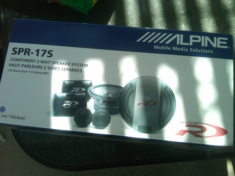

These seem to be the speaker of choice here, thats why I went with them. Haven't installed them yet so I have no idea about needing spacers or just using the adaptors. I have the adaptors and a spare sheet of 5/8 mdf just incase. Let ya know tomorrow hopefully.

I would stick with Kappas over the Type R. You can fit 6.5's in the front doors with the adapters fairly easy or just get the Kappa 6x9's. There are boxes that fit under the back seat. Get a shallow mount Kenwood, Pioneer, or something that will match the Kappa amp RMS output as close as possible.

Do yourself a favor and don't get the adaptors for 6.5 simply do what weed did or i used 1/2" plywood and made mine today. Install was a breeze once I trashed those flimsy plastis adaptors. Alpines sound nice, heard good things about the Kappas too.
