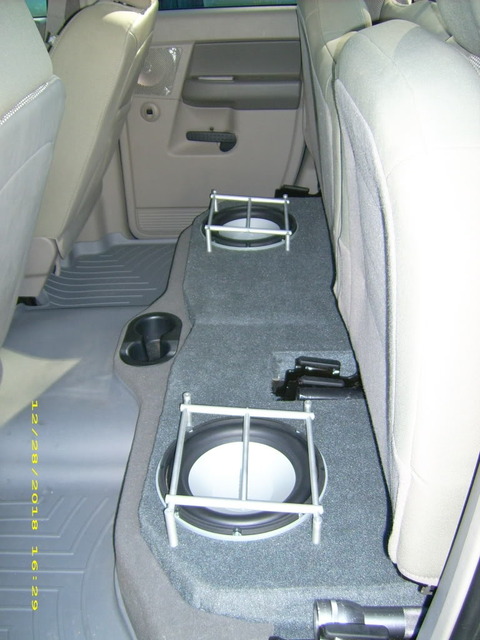

Im sure someone does, not my intent to buy pre-fab. That was the rough cost of the entire project, not just fiberglassing a box. I made these extra stiff and formed just right for these DVC subs. Point is, what was originally intended to be a free project, quickly got out of hand due to wanting more.
Supplies, extra resin, wiring, subwoofers, cap, mdf, luan, carpeting...etc

That's a very nice looking box but you'll burn your subs up like that. With the seat sitting on the subs like that not only are you tapping heat but the subs also have nowhere to flex which makes them work alot harder. Which means they'll be far less efficient, get hotter, and draw more current. Also note: capacitors are useless for sub installs. They're better suited for your mids and highs seeing as though they draw more continuous power.

Looks real good!! Nice Job! I like the looks of those subs, do they sound good?
Here's a pic of mine. All wood though, and not quite as smooth/clean as yours but solid as fu>k
Damn dude. The only nice thing you had to say ended with a negative. Maybe he only plans to run the subs with the seat up? Also, the seat will allow them to breathe somewhat as it's not completely solid, but yeah, it will heat up the subs and mute them a bit.
Caps aren't useless, they just arent as useful as many think and most guys dont size them correctly for their particular system. I personally have a Batcap which is essentially an AGM battery with a discharge rate of a cap. It's equiv to 300farad and allows my alternator to have an easier recovery where as a smaller cap depletes the battery level more.

I appreciate your comment but you know what they say, opinions are like ********, everybody has one. Haha. Just giving you guys a heads-up, the seats dont actually "rest" on the subs...the impression of the subs you see on the under-seat is from loose fabric draping down and me load testing the seat trying to see if it would touch, which it does not. There is a gap between the subs and bottom of seat, and there is no loos of sound quality with seat up or down, it all sounds really good without muffling or heating up, as designed.
The stiffening cap was installed to smooth out battery draw during heavy bass moments due to having significant headlight and interior light dimming. Although its only 2 farad its exactly what I needed for my reason. Problem solved, no more dimming, no 5 extra batteries, no secondary alternators. I did what was needed, useful, and complimentary for this application.....it fits my needs and truck perfectly without any issues whatsoevever.
Please remember, this is no SPL truck, i am not competing against anyone. Just a guy who wanted a mild subwoofer upgrade to listen to while plowing and salting roads all night. Mission accomplished!
