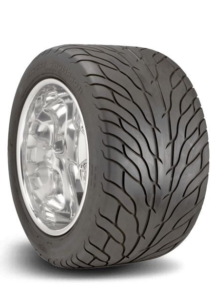

Aluminum slotted rims are my favorite! I used them with Pro Track tires(with white lettering). If i where to do it again today i would get a large diameter rim and put on a tire like this...
This is a Mickey Thompson Sportsman S/R Radial. But can't go wrong with BFGoodrich radial t/a's either.
