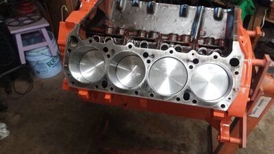

New Speed Pro's 0.40 over in RPM Racing Engines prepped 72 440RB.

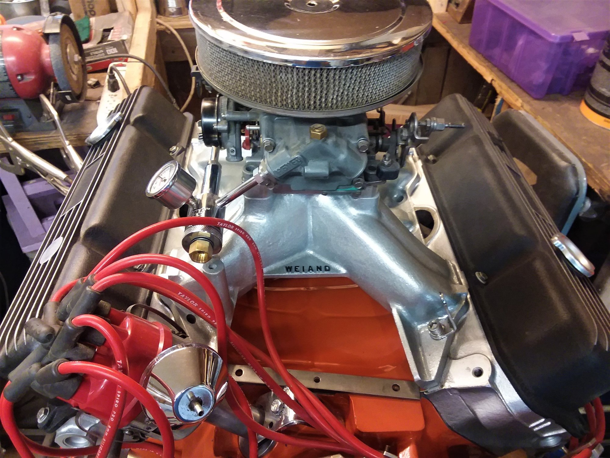

Weiand single plane powder coated in Alien Silver & black by Phoenix Specialty Coatings.

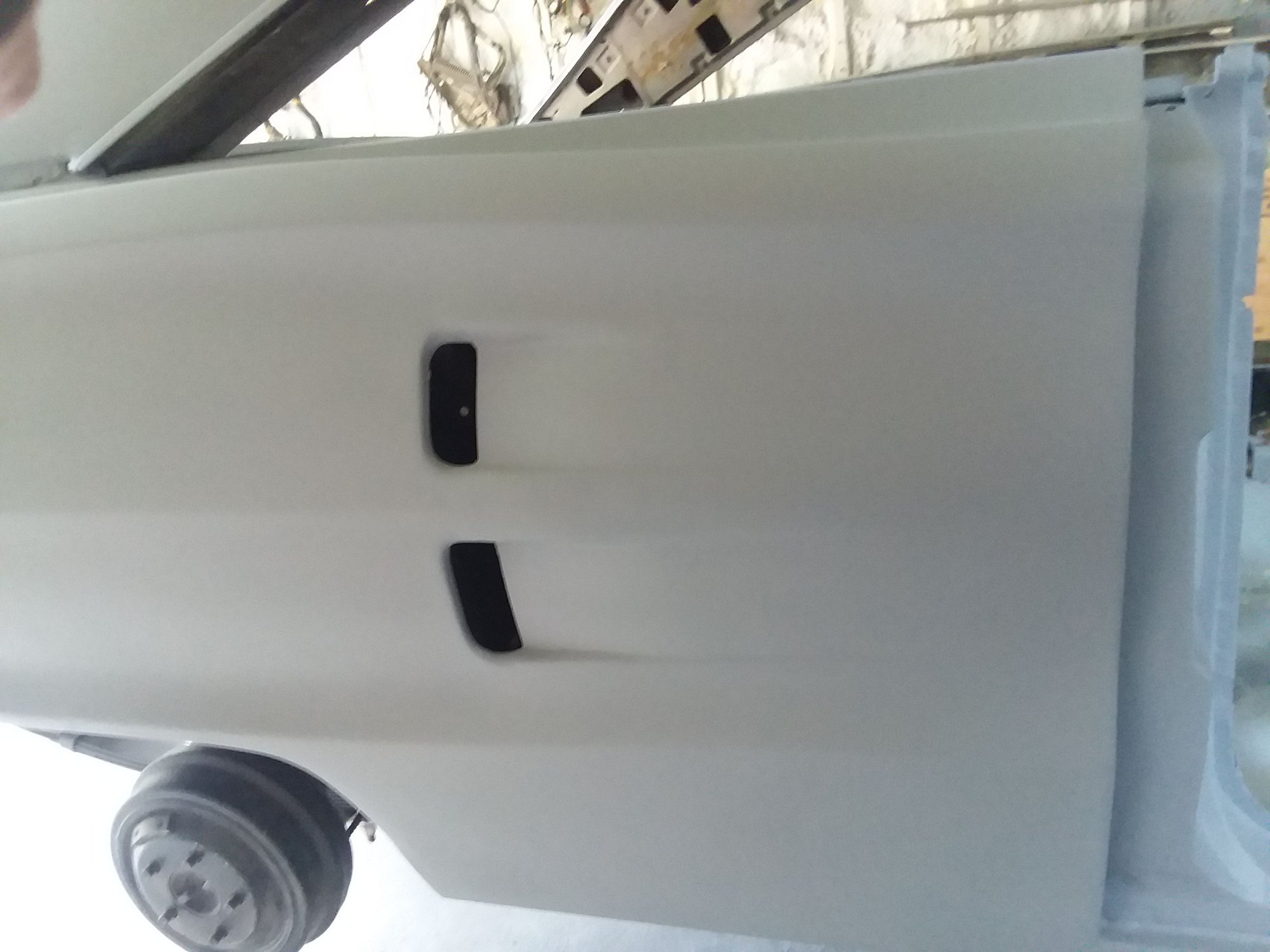

67 Coronet 500 side scoops opened up.

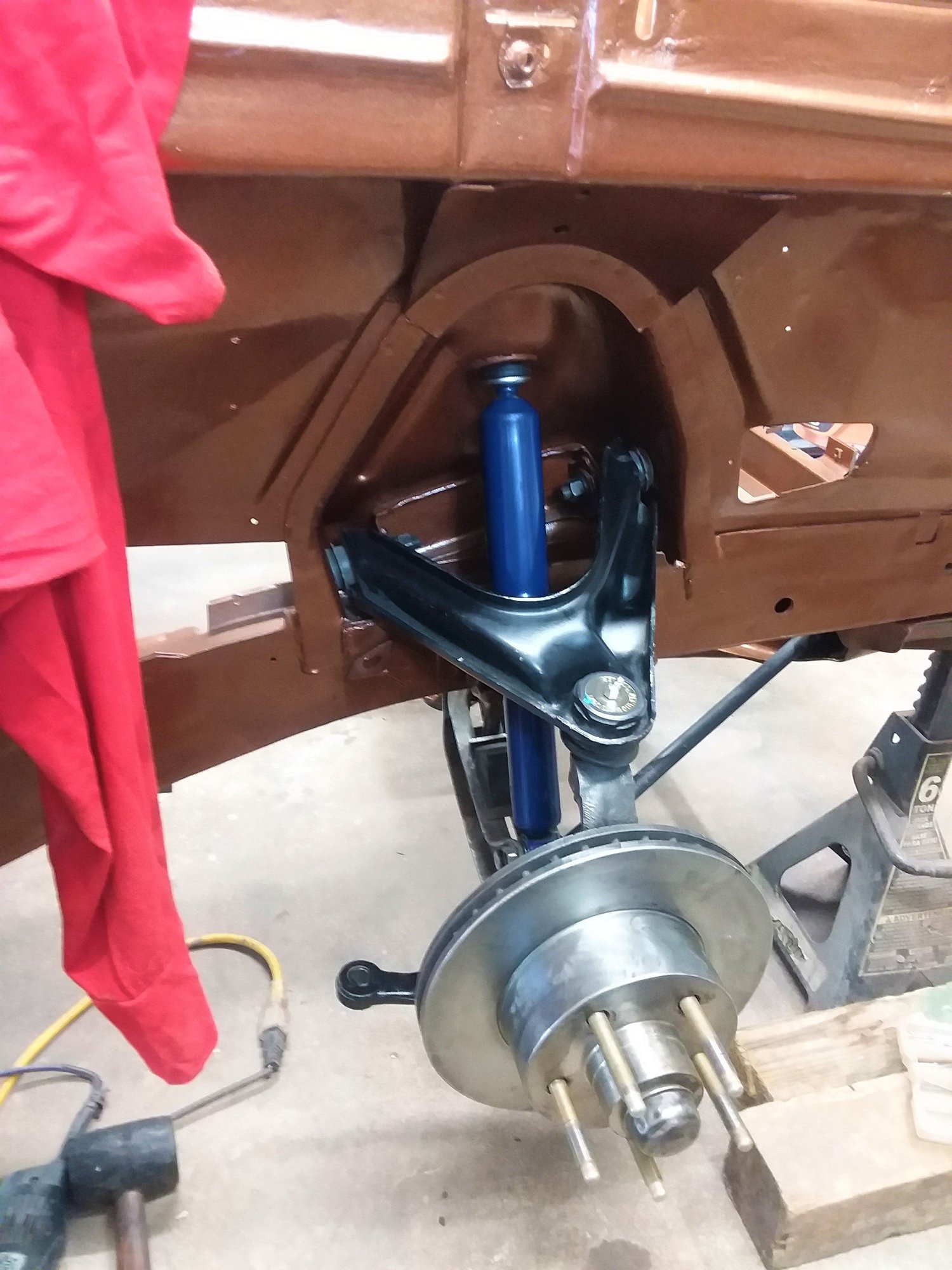

1976 Aspen front disc brakes swapped in with all new parts.

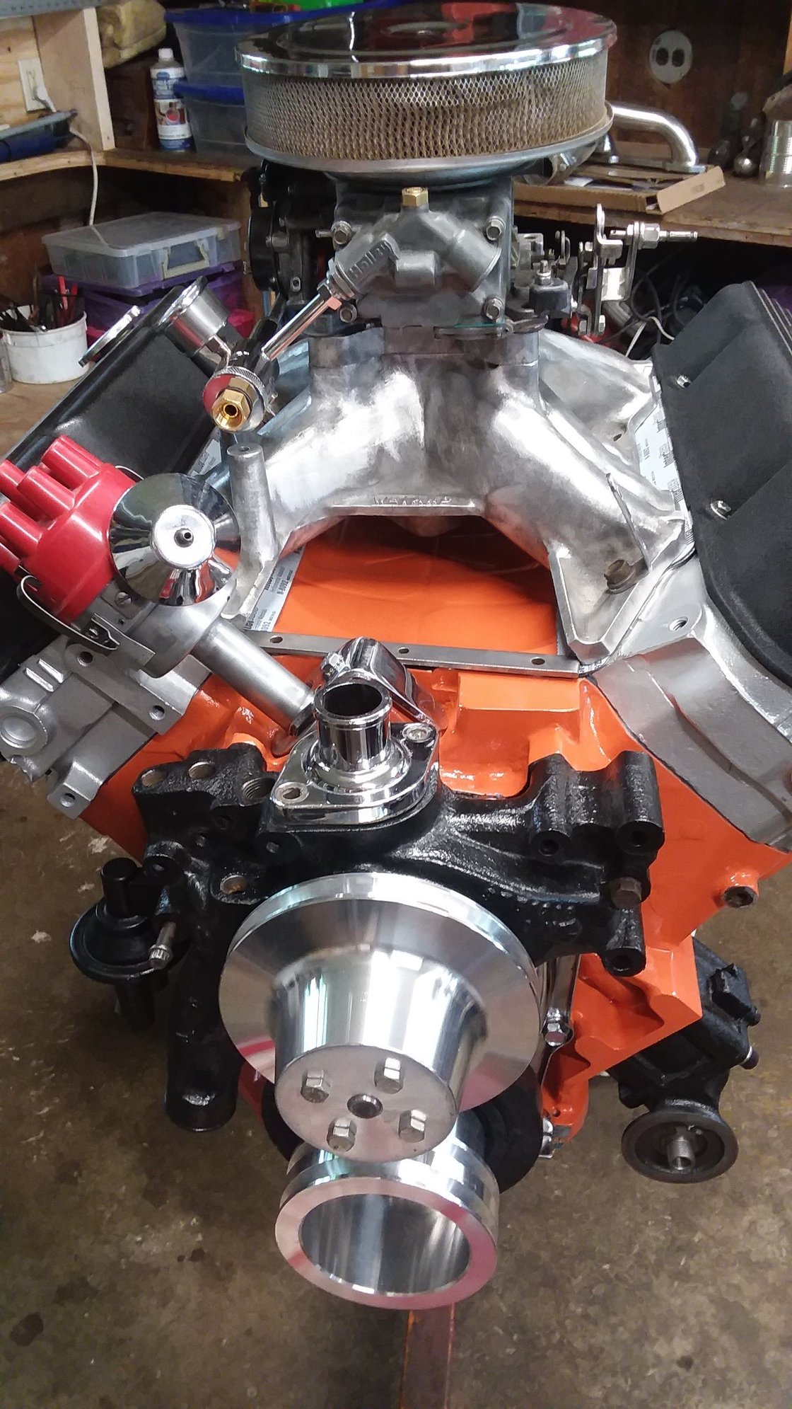

Brute Force 440.
