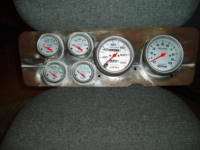

And the new dash!

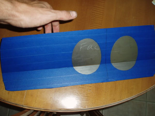

Just cut out of thick gauged steel, outline was traced from old dash.

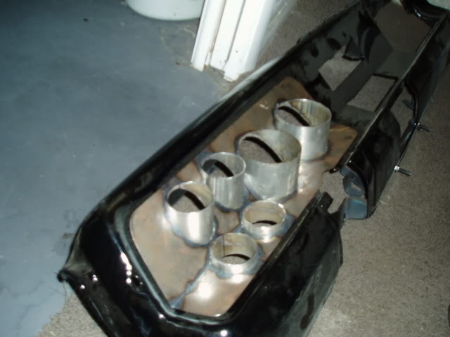

Then I went to a local shop and asked for some scrap exhaust tubing.

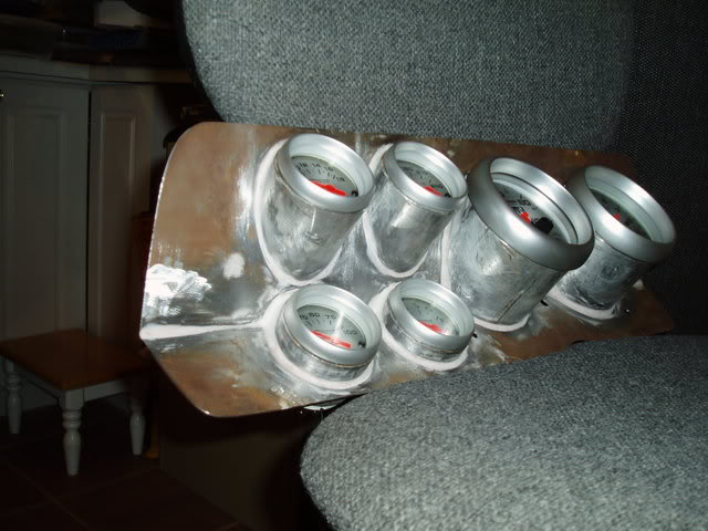

Bondo'd up the corners, weld joints, and such.

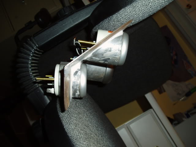

side view.
you guys have already seen the finished, ill take more pics as the intrerior progresses, if anyone has any specific questions about anything just ask
