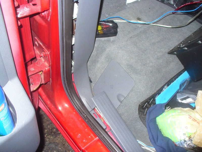

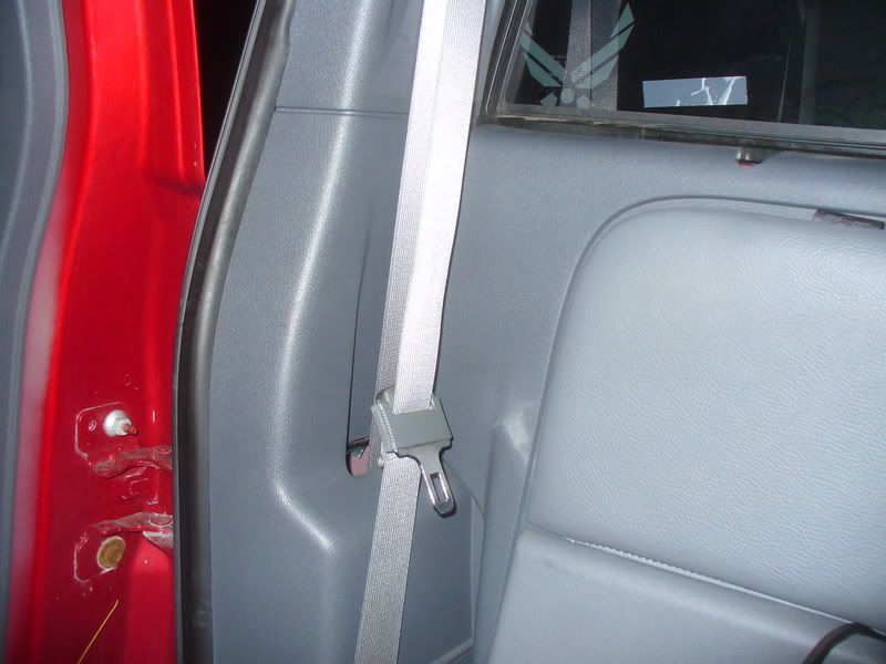

Next you need to remove the "C" panel trim. That's the trim with the seatbelt attached to it. Now you have two options you can
A. Remove the upper trim and the seatbelt,
B. Bend the lower trim plastic out from the upper trim and pull it out of the way.
I opted with B and just removed the lower trim leaving the upper in place.

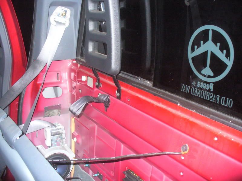

This leaves the head rest bolts exposed. There are two per side.
Once you remove the second bolt hold on to the headrest because it will fall straight out of the ceiling. Accomplish this on both sides and you are done.

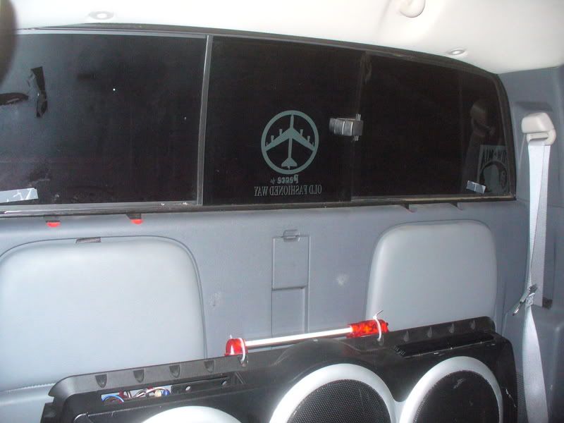

Before:

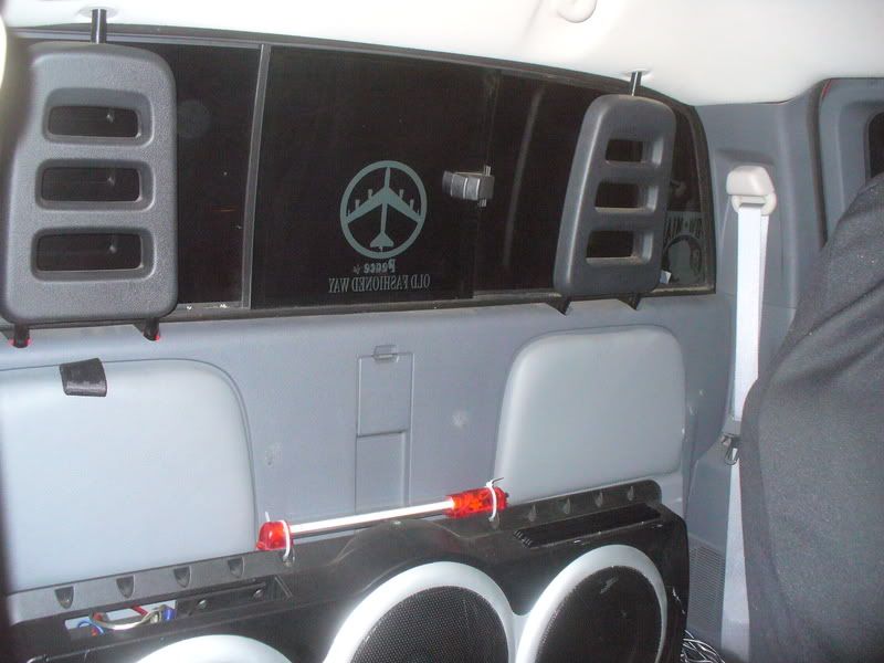

After:
