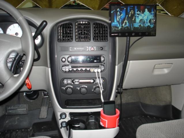

So the new unit would not play on a universal monitor. Evidently there is something in the factory wiring. After some internet searching I found a guy who could open up the unit and solder on some leads directly off the laser pick up so I can use the video signal. After that it was pretty easy to install an LCD monitor on a bracket by the front passenger seat. This unit also has the front rca jacks for an ipod or other device.
I spent a total of about $375 and now have a pretty cool custom DVD system. I eventually will add a tv tuner when I can find one that picks up the new digital signals.
Attached Thumbnails Factory dvd/cd-dsc02196.jpg
