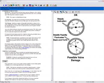

Mitchell on demand and alldata both says its an interference engine.
But....lets suppose the belt breaks at a point that the valves are closed or on their way to be closed....like half way there.....it wont touch......the cams will stop turning but the crank will continue....
It will touch a FULLY OPEN VALVE with piston at TDC
Alldata pic included
