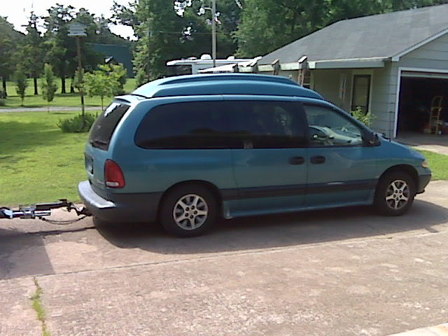

But we just moved 3000mi from the west coast, and the Turtle van (Mod5 bubble top conversion) fully loaded pulling a fully loaded trailer made it with no problems at all.
Those are the seats strapped to the top of the trailer, the rear bench seat is inside the trailer, the van was PACKED to the roof!
The trailer was STUFFED!! The bike on the front of the trailer was for just-in-case I broke down, never needed it.
