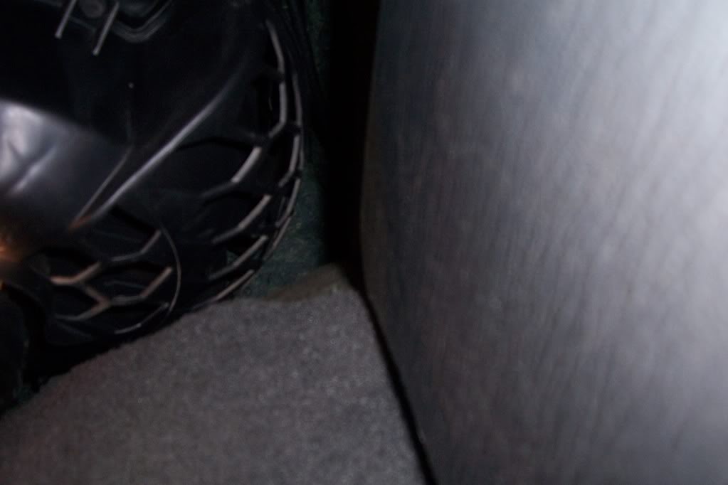

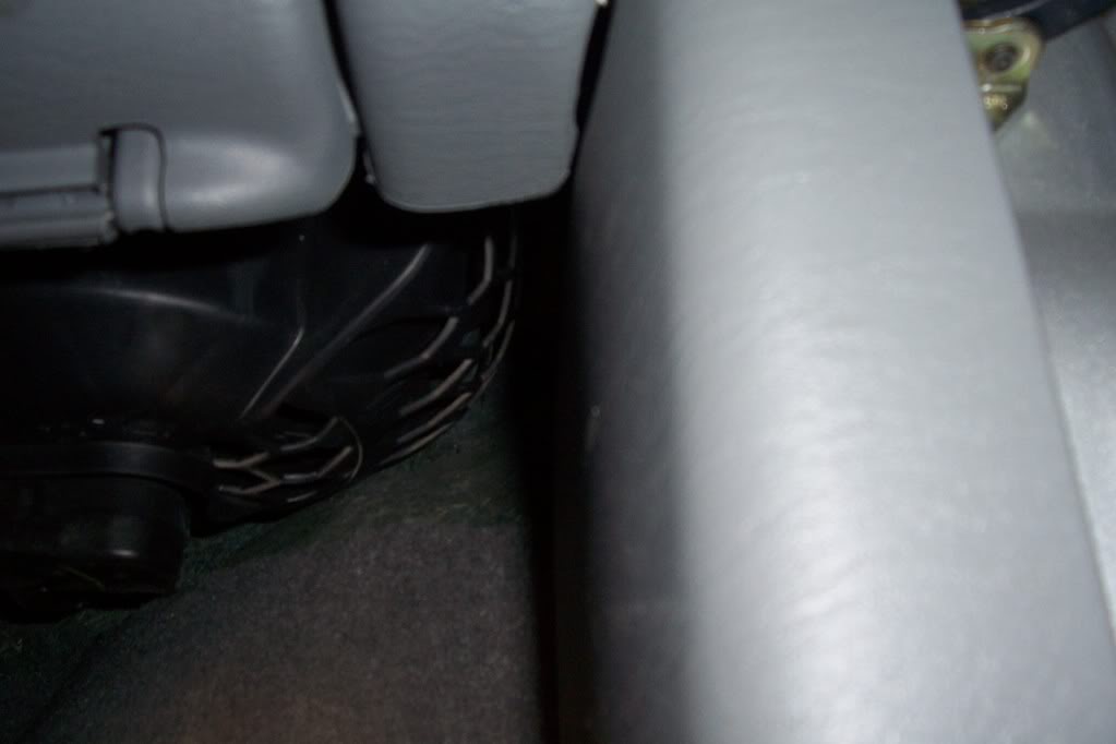

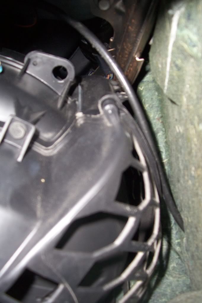

here's some pics of mine from an 06, should be the same model as yours
right inside passenger door and under glove box, I was able to see it move when turned on the re-circulate

Both the pictures and the drawing help, however, I am still kind of confused in where exactly to look for this recirculation door & unit. I checked behind the glove box, but that didn't reveal anything. When you say that it is on the floor in the passenger footwell, do you mean that it is underneath the raised portion of the floor near the kickboard. There is a spot, that is raised some, where something like that could set underneath. What do I have to take apart, to get to it, e.g. carpet, moulding etc.? Don't want to ruin the carpet or anything. Thanks for your help.

the black honey comb looking thing is the recirculation unit, the door is inside of it, you can see it move if you hit the re-circulate button while looking at it,
you do not have to remove anything to see it, just open the passenger door, lay on the floor and look up to wards the bottom of the glove box it is sitting under it up against the out side of the van, you will need a flash light and maybe a mirror to be able to see it move, but you will see a black plastic bowl shaped door move inside of the honey comb

Thanks for the clarification on the location of the recirc. unit. I did find it and unfortunately the door is not opening at all when the recirc switch is depressed. So it looks now, like either the actuator has stopped working or something like that. I was hoping that the door may just be stuck, but now it appears to be an electrical problem. Are the actuators very expensive and how much of a problem is it to reinstall another one? I guess, as long as the rest of the AC is working, I can live with that. Anyway, Thanks for your help on this. I do have some other pressing problems such as front disc brake pads that need attention and I may have went too long already on this. Thanks again for your pictures and explanations.
