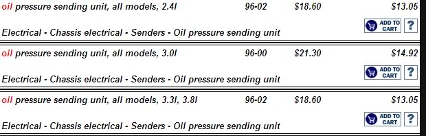

if sticking with mopar try dealer or try here
http://www.moparpartsamerica.com

k next time when asking for advice please provide the required info like what engine you have
if you have a 2.4L its on right side of engine Block
if you have a 3.0L its right near the starter
if you have 3.3 or 3.8L its right below the A/C compressor
