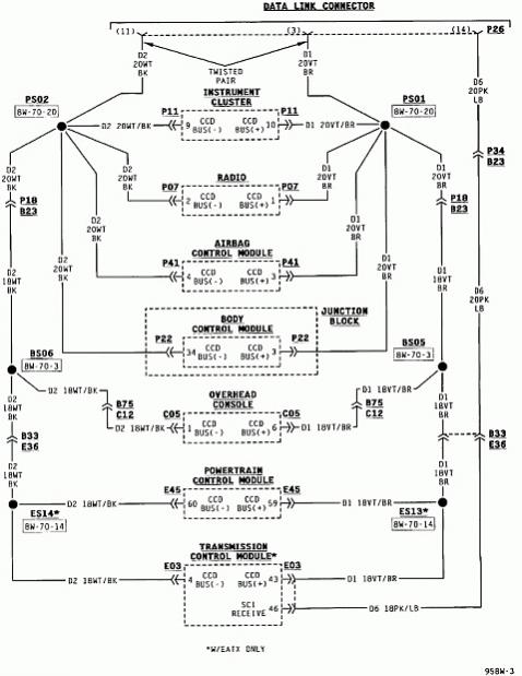

When the gauges go down I've found that the DLC connector is also dead. Because this problem kills everything in the vehicle, I was tending towards looking at the CCD bus integrity. Everything shares this bus. Unfortunately (fortunately) the problem has gone away and I have ceased looking at it for now.
Here's a link that discusses this possibility.
http://forum.chryslerminivan.net/sho...avan-Sport-3.8
